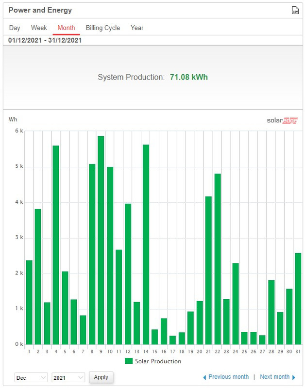

To those with solar - are there winter days where you produce 0kwh? What would a typical winter day look like in terms of kWh production?
4kw system with optimisers, this is last December, I think the worst December I've had, the lowest day was 0.274kwh on the 27.
Actually the 17 was 0.261kwh
