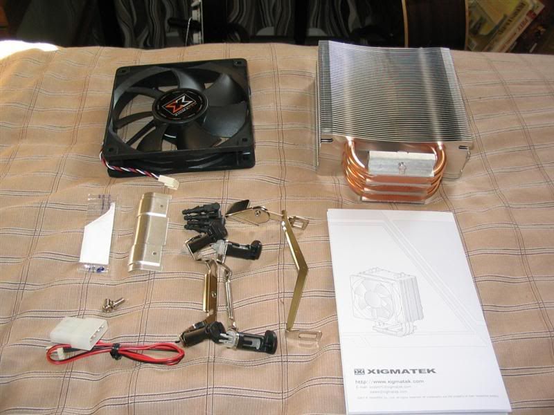

The box:
Contents: You get a 1300rpm PWM 120mm fan with some silent mounting rubber thingies, some AM2 bracket and the annoying push-pin S775 clips, in addition to a funky spoiler thing for directing some airflow down over your mosfets or whatever, a molex adapter, and of course thermal paste.

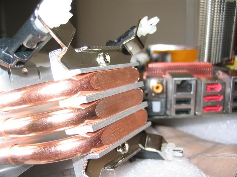

The Cooler: Just your standard finned heatpipe tower, except the heatpipes are on the bottom for direct contact with the CPU.

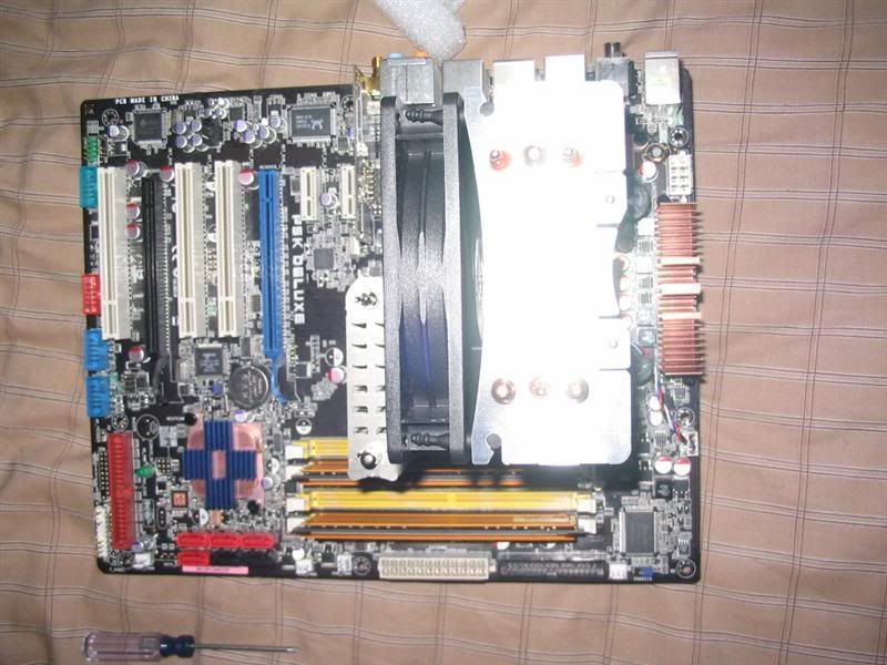

Fitment: I've always had water for my intel setups so I've never had to fuss with these weird mounting clips. Man are they super lame. Anyway, I finally got it fitted with just enough room for my HR-05

Nice fan :)
You just made it between the HSF on the board and the cooler.
Why the other fan strapped to the Zalman?
Nice fan :)
The other fan is strapped there because I accidentally broke the fan header off the 3d card and don't have a soldering iron around...also the 92mm fan can be controlled via speedfan and the GPU fan can't and runs at 100% at all times.

Would that fit facing the rear of the case, i.e rotated 1/4 turn ?
I think so, but it would hit the thermalright HR-05 I had installed there.
On my P5E it won't fit facing the rear because of all the heatsinks and stuff around there. My antec p182 has a fan on top sucking out though so airflow is still very good.
