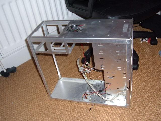

Firstly pictures of the poor old, battered and unloved case:
All but one 3.5” bay blank missing, As you can see there are marks on the front of the case where the scratches have been sanded out and the anodising has been sanded away. You can also see the original I/O with just two USB ports
Marks on the top of the case, Holes in the back of the case and the missing PCI Covers
Side panels removed
New Drive bay blanks arrive
With new drive blanks in place to hold the internal drive bay structure together, de-riveting happens – it’s all in pieces now!

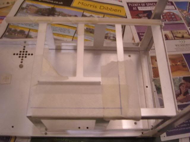

With the frame back together I discovered that some adjustments needed to be made so that the panels would fit back on correctly, so masking tape and red pen at the ready I marked off where I needed to cut so that the panels would fit again. New cuts have been made

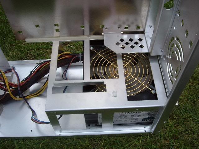

Due to the age of this case (I think it must have been one of the first 201s) there is no PSU mounting bracket. Imagine my horror to find that the PSU was a really tight squeeze between the drive bay chassis and the PSU bay chassis – so tight in fact that I scratched all the side and sticker on the PSU trying to get it in and out – Now are the new PSUs bigger? Or was it my riveting back together that caused the problem, I’ll never know!

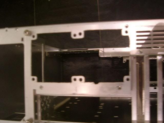

So next job was to make the insertion of the PSU much easier by removing some of the frame. All marked up for cutting. Most of the PSU cage removed
In order to bring the case a little more into the future I decided to add dual fans on the motherboard tray. Fan position marked and holes drilled all be it a little wonky, time to cut! All roughly cut out. And all cleaned up to the best of my ability.

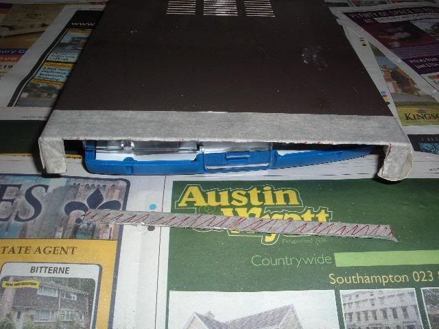

Next onto the top panel, with the motherboard tray now being near the top of the case the top panel would have to be taken off to get the motherboard try out. Marking up of the part that needs to be removed. Cutting done. Top panel back in place and you can see the motherboard is now free to slide in and out without having to remove the top panel

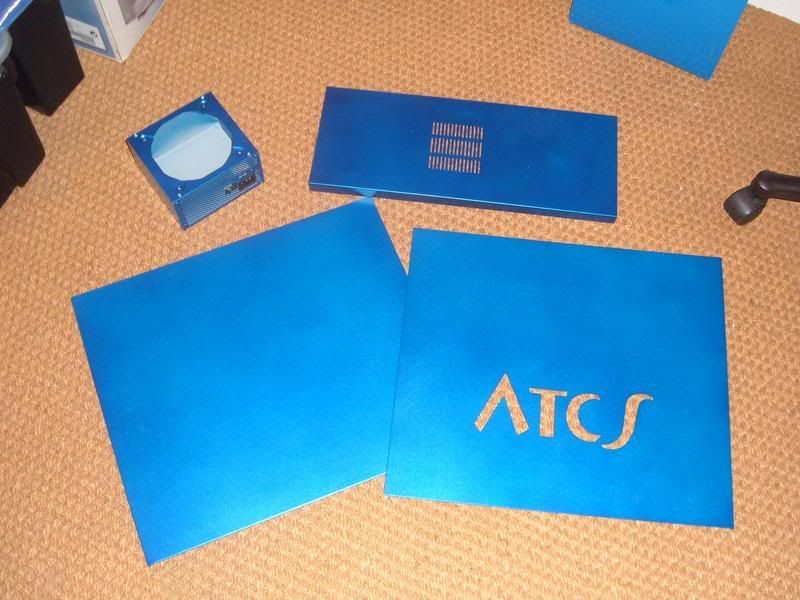

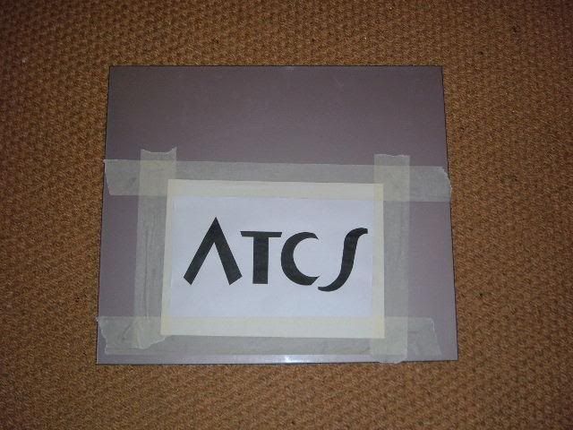

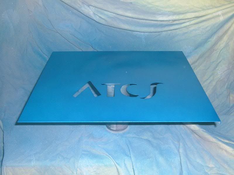

While all this modding was going on I decided on what’s happening with the side panel, I wanted the ATCS logo cut out of the side and a piece of acrylic inserted from the rear to protrude out the side, this would then be lit from behind.
Due to my dremel/jigsaw skills lacking, and the fact that I thought it was too complex to even attempt, as anything other than spot on accuracy would look pants, I decided to send the side panel off for CNC routeing (many thanks to Signs Express Grimsby)

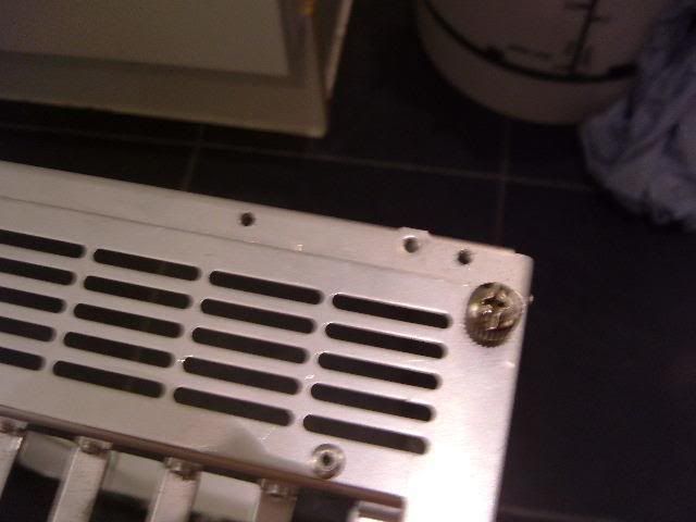

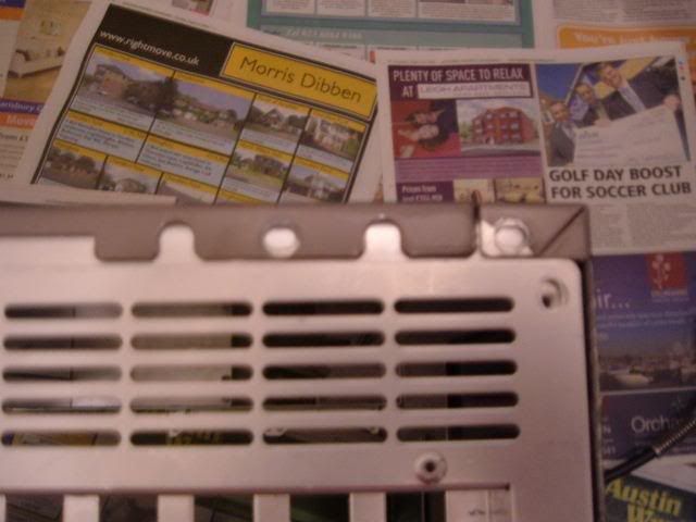

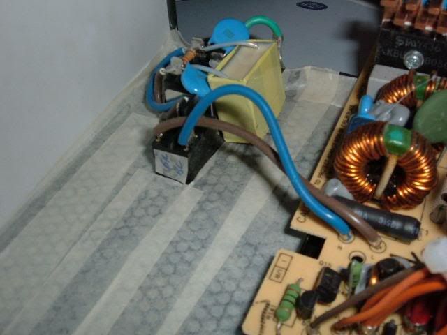

Due to scratching the PSU I decided that I would paint it up and produce some new stickers for it. Scratches and old sticker

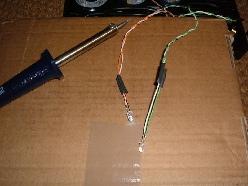

Time take the fan apart, de-solder and mask up

First it was time to strip the panels and PSU casing, panels are gong well, hmm the PSU case isn’t going so well, the paint wouldn’t come off! Preparation before painting – the panels get a nice hot soapy bath
The panels are primed and all is going well, time to add some colour, the colour of choice is Plasti-kote Metallic Blue – this is where it goes wrong! The side panels start to bubble up and blister.
Very disappointed and disheartened at the prospect of having to start all over again! However the PSU cover and the Top panel are fine, and the chrome paint on the front grill looks good so it’s not all bad!

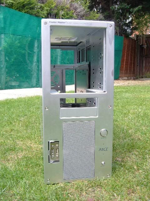

While disaster is striking the painting and I have to strip the side panels back down and start again, the front panel and all parts were sent to be polished to remove the writing and anodised blue.
On their return I am very pleased with the colour and it matches extremely well with the metallic blue paint! (Many thanks to custom colour anodising)

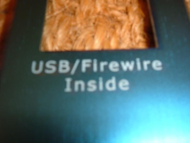

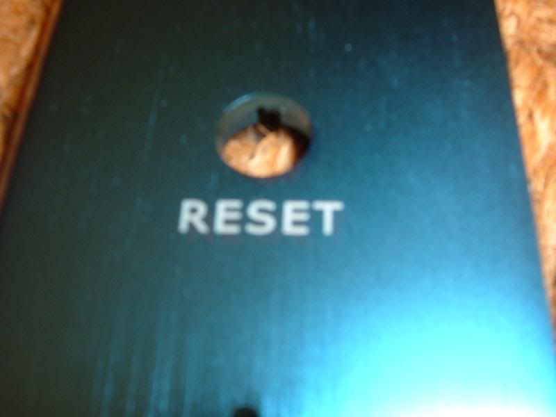

With the polishing and anodising removing the writing on the panel I decided to have the important info laser engraved into the panel. The layout was set up and the panel sent off to be engraved.

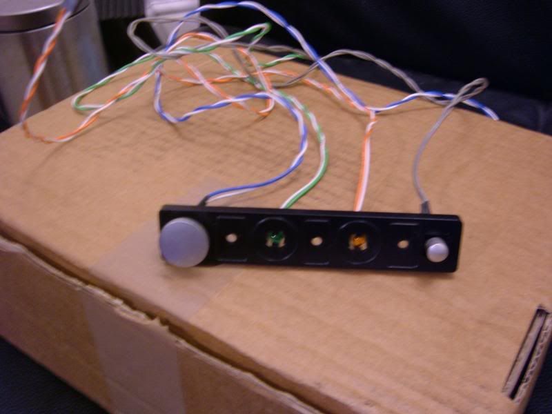

Some small mods while I get up the courage to start painting again! Firstly re-assembling the front I/O port with the new USB/Firewire/Audio headers
The front panel arrives back from the engravers in record time and even if I say so myself it looks fantastic! (Many thanks to Tamatec for the laser engraving) Sorry for the following poor images, I’m not so good in macro mode. Better picture later on!

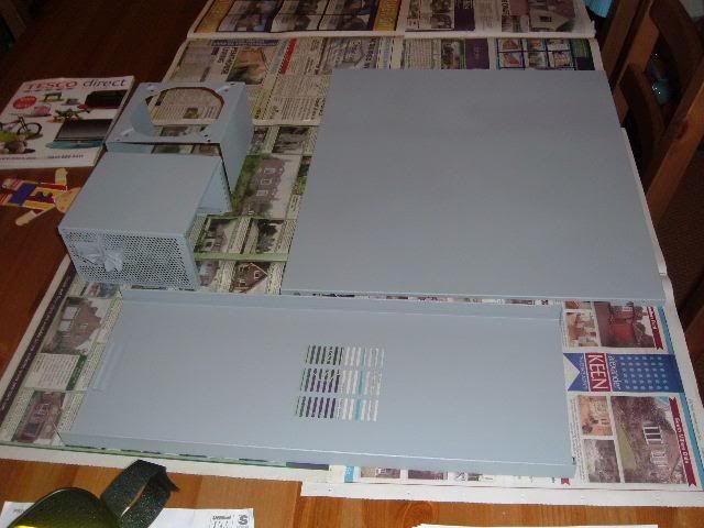

Now time to let the painting begin again! This time, in my Fathers garage. First the primer goes on.
Then the colour, this time I’m going slower – as I was told I had sprayed the paint to thickly last time. So first coat
Second coat

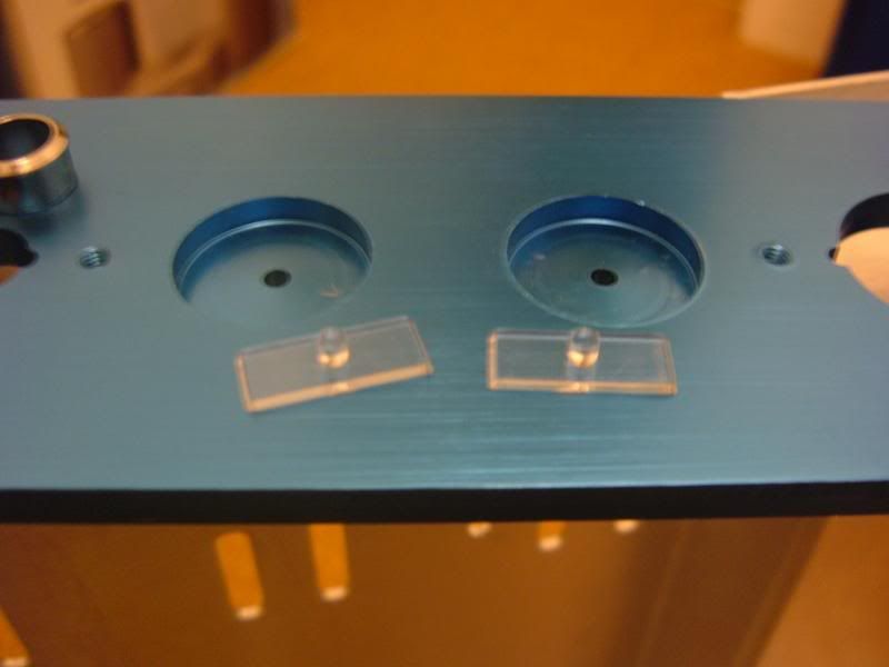

The Light conduct Lenses arrive from the CM parts shop NL, I broke the original ones trying to remove them for the anodising. So time to put the front panel back together. Secured in place. Looking very sexy!

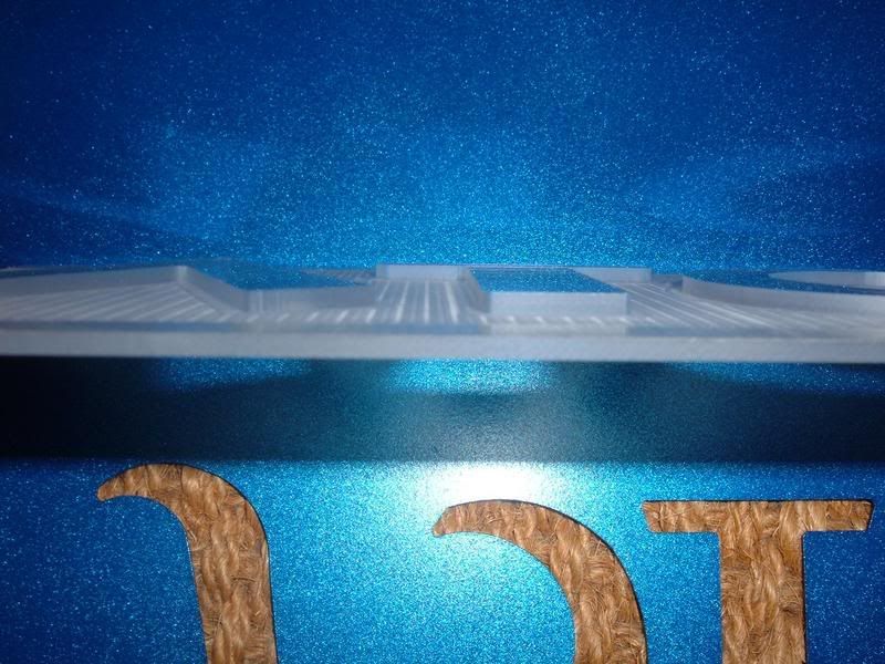

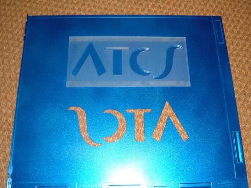

Now for the side panel! The panel and the acrylic, A Closer look at the Acrylic, Securing the Acrylic in place
All done!

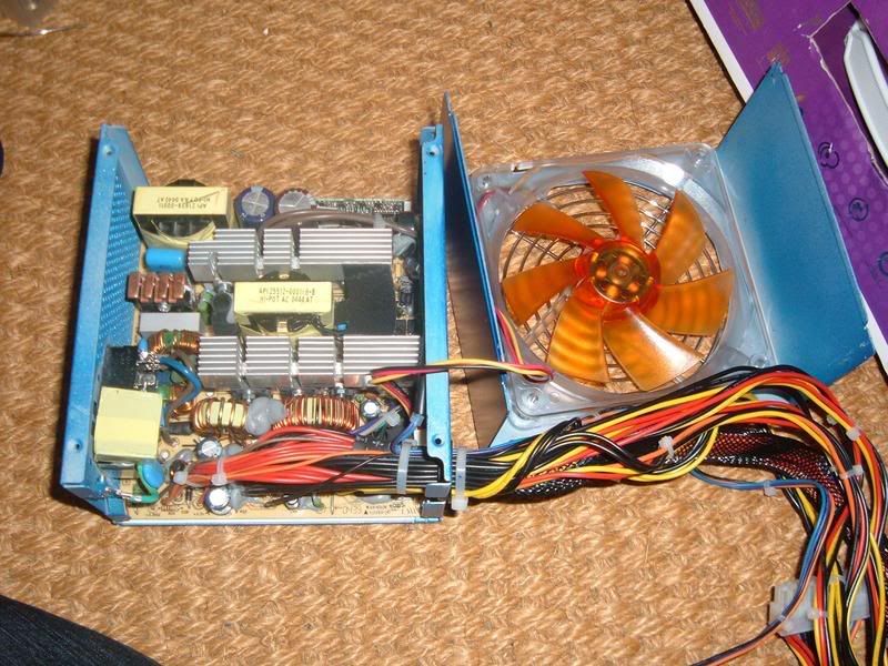

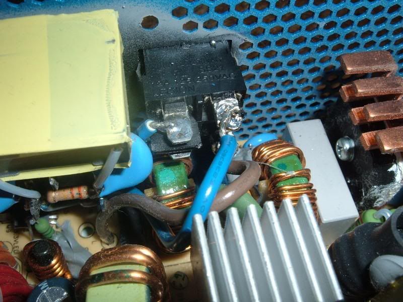

With the arrival of my 120mm Akasa amber fan it was time to put the PSU back together. I looked on the CM website and found a PDF with details of the Real Power 450w PSU. I used this to make the artwork for the new stickers
All the bits ready to be put back together, Soldering the wires back in place – I hope it still works! Fan installed
New Sticker ready to go on, New sticker secured in place, PSU ready for action
