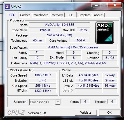

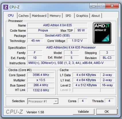

I've noticed one thing while watching CPU-Z. In between tests and also randomly my CPU frequency, multiplier and the voltages are dropping, almost as if cool n quiet is on (it's off though, via bios).
Here is a pic of CPU-Z under normal conditions
and here's a pic of it when it slows down
Any reason it's doing this?

Cool n quiet is recommended off when overclocking, that's what I've read everywhere anyway. Thing is when at idle when nothing is running it runs at full speed. It's just under load that it slows down...
Sometimes it's beneficial to turn it off while finding a stable overclock but then turn it back on afterwards.
If your CPU is throttling back when under load perhaps it's a temperature issue.
I see. Well temps are fine, with the current OC temps are not going past 57C under load so they're within the limits.

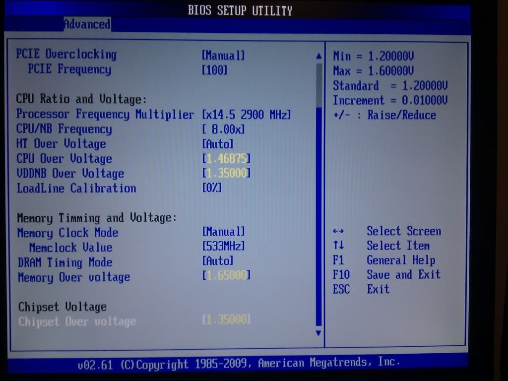

The problem where the voltages go from 1.152v - 1.536v was LLC related. It was set at 0% with 1.4625v vcore via BIOS. The system is stable with this setting however. I tried different LLC percentages up until 38% were the voltage actually dropped at load rather than rose. They ALL caused instability though, with the system rebooting only a few minutes into prime95 small FFT's. So I'm running 3.6ghz (overclocked it a tad more from when I created the thread a few days ago) with 1.4625v and 0% LLC. It runs at the voltages I said above which are a bit high for my liking, would like closer to 1.45v but it just seems 3.6ghz isn't possible with those voltages and it prefers 1.53v (tried LLC at 16% and under load it was 1.5v and crashed). Temps are 55C max under load though so I'm happy with them.

Might be worth setting memory timings manually if it thinks you're running it at a slower speed it might be trying to tighten the memory settings but with a higher fsb it's actually running faster than it can handle those settings?
I'm already running the timing manually. They're running at 8-8-8-20-27 1T.
CPU core voltage is 1.476v, can't seem to get it stable if it's lower than that.
