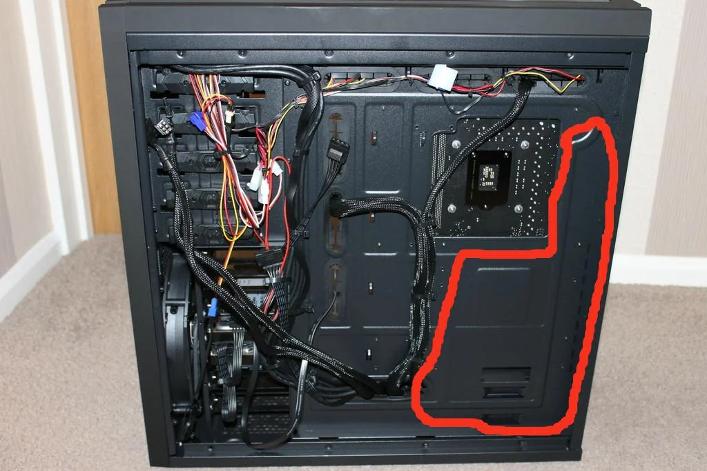

That is one thing, which I would like to see improved on the Bitfenix cases kul1 that I mentioned in my review of the Raider! :p
To have about 5 cable mounts/loops spread out evenly inside the area surrounded by the red line.
