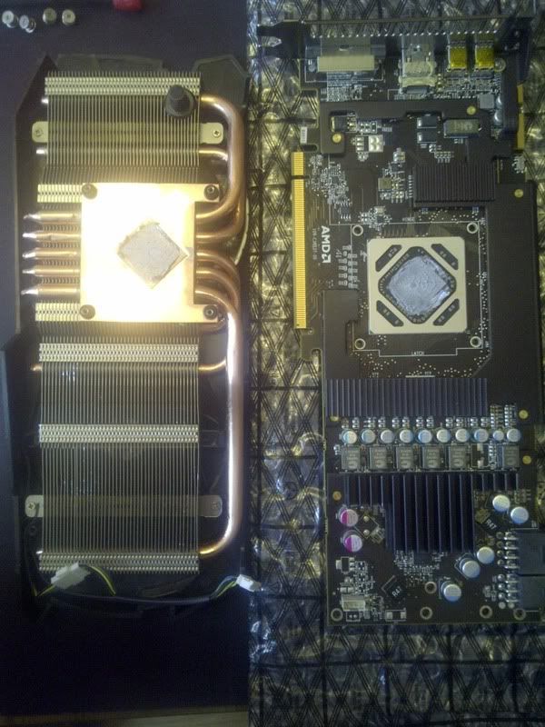

Following on from later posts in here, I figured I should get my own thread and show you what pointless stuff I've been up to :D
Today, I got bored and thought what the hell and removed the dual-x shroud/fans and stuck a couple of Spectre Pro PWM 120's on there with the aid of two thin strips of gaffa tape and a couple of rubber bands.
Hey, I had no cable ties lying about and there's nowt wrong with ghettoing it in the name of science :p
TL;DR? Have some crappy phone-cam pics. Turns out my Blackberry is actually a potato...
I used Arctic Silver 5. Despite the conductive properties of AS5, it's all I had to hand and I used the spread method to ensure that no paste could possibly ooze over the edge of the gpu core.
So how did we do?
Sorry to spoil it, but the answer is lolwhut or just meh...

I'm at a little bit of a loss to explain this.
With the core temp, I could argue that since the stock heatsink is so thin compared to an Accelero and certainly an Alpenfohn Peter, it can only do so much regardless of what fans you throw at it.
Therefore, the stock setup is fine as it pretty much hits the limit of what the heatsink is capable of.
Looking at reviews (pro and user) and seeing their core temps when using the above mentioned coolers seems to back this theory up and we all know that more surface area = better heat dissipation.
As for the VRM's... You tell me lol. No, really.
I have a few theories, but I'd be interested to hear your opinions.
