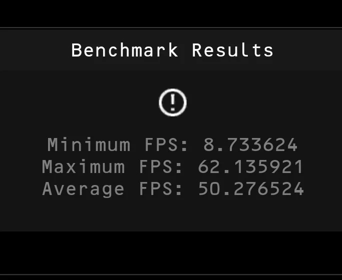

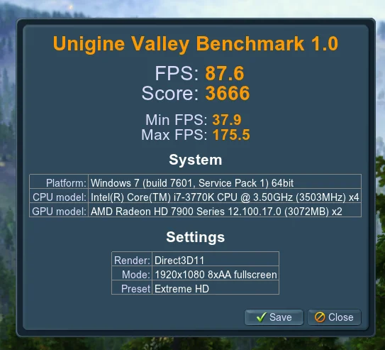

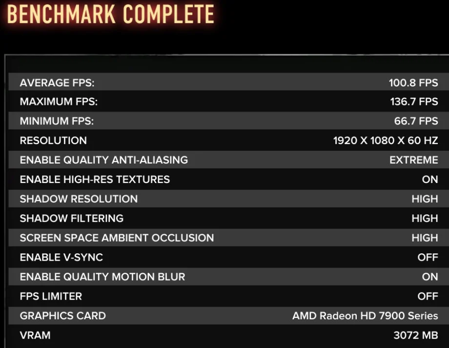

7950 CF @ 1100/1500:
3D Mark 11:
Bioshock Infinite:
DiRT Showdown:
Heaven Valley:
Hitman Absolution:

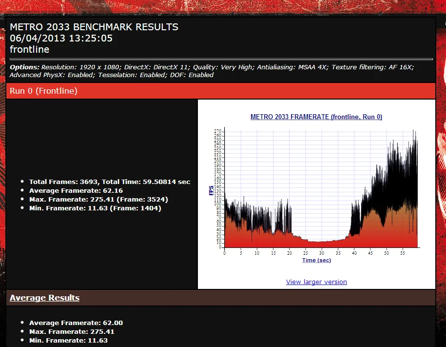

Metro 2033:
Sleeping Dogs:
Tomb Raider:
7970 CF @ 1100/1500:
So to compare the clock for clock difference (average FPS) are as follows:
Bioshock Infinite: 3.8%
DiRT Showdown: 2.2%
Hitman Absolution: 2.7%
Metro 2033: -1.7% (potential testing anomaly as the benchmark is a bit sketchy)

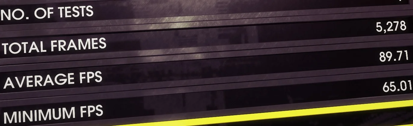

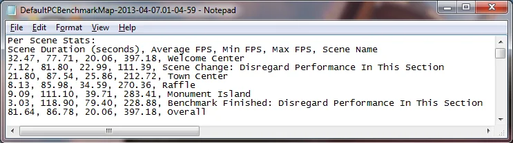

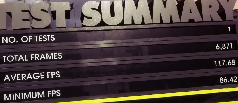

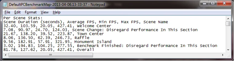

Sleeping Dogs: 3.8%
Tomb Raider: 4%

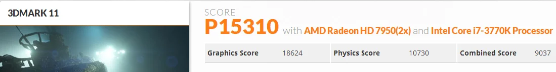

3D Mark 11: 5.8%
Heaven Valley: 4.7%

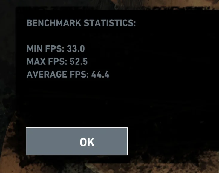

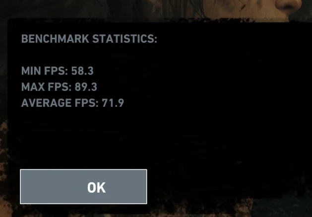

And here are the 2560x1440 results:
Bioshock Infinite:
DiRT Showdown:
Hitman Absolution: (actual minimum FPS was 44 - benchmark bugged out)
Metro 2033:
Tomb Raider:
Hitman Absolution: 1.9%
Tomb Raider: 5.6%
Sleeping Dogs: (Rusty unable to complete due to driver issue)
DiRT Showdown: 3.7%

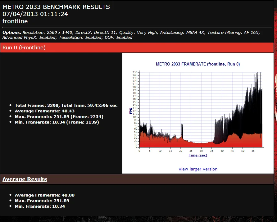

Metro 2033: 9.4%

I ran these the other night when I saw Tonesters results, slight difference from Rusty's but I have a quite a few background programs running and it may have an impact or not.

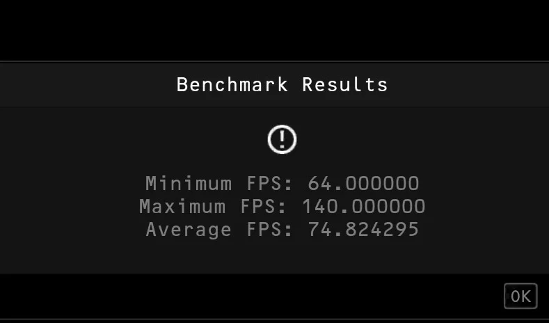

2560x1440 results. Will update post #2 as well.
Had to skip Sleeping Dogs as on these drivers I can't get it to run at 2560x1440 when any overclock at all is applied so some issue there. :(
Bioshock Infinite:
DiRT Showdown:
Hitman Absolution: (actual minimum was 44 FPS but the benchmark bugged out upon completion)
Metro 2033:
Tomb Raider:
