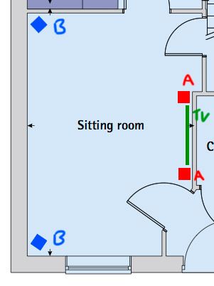

The living room isn't huge, 4.4m x 3m.
Here's a layout of the room to help.
Now my options I'm thinking at the moment is either:
1) Get something like B&W 684 (or 683) in position A in the room only.
2) Get something like B&W 685 (book shelf speakers) in position A only.
3) Something like B&W 685 in position A and B&W 686 in position B too.
I could happily spend up to £500 for an AV receiver, I'm eyeing up a Denon 3313 for £595 at the moment.
My concern is that for this size room, 684s or equivalent would be too much, and instead a decent pair of bookshelf speakers would be more ideal. So I'm swaying more to option 2, and then later on maybe get some additional speakers in position B.
I could happily stretch to £800 or so for some floor standing speakers, but I'm worried it's a bit overkill for the room.
Any advice for this type of setup would be great :)

For your money I would put it towards quality front speakers and leave surround sound for later. Also whats the room like for light, and have you thought about Panasonic plasma's at all?

My first thoughts: You seem torn on speakers between just a stereo pair or some sort of surround. If purely stereo then go with the 684 floorstanders. You haven't mentioned a sub so you'll need something with a bit of bottom end grunt to keep the sound balanced.
If you plan to do multichannel surround then you can think about some smaller speakers all round (685 fronts + 686 rears) but again you need some bottom end grunt too. So a sub makes sense. What would be in the back of my mind though is that the front wall is fairly small. You're likely to go for the biggest TV you can afford. Is there going to be enough space for the speakers as well?
I would keep my options open I think. The Monitor Audio Radius HD speaker range might be a useful alternative. Radius 45HD's at the rear are small and discrete and do a great job of ambience rear surround. Up front the pick of the bunch is the Radius 225HD. They are designed for wall mounting and would look good as well as sounding great either side of the TV. The speaker can also be mounted horizontally as a centre speaker. (These are priced as singles, so remember that when totting up.) Radius HDs are also available in a range of colours. Then add the sub of your choice.
Alternatively, go for the MA BX5 floor standers and mix 'n match with either the R45HD's again for rear duties or the low profile dipole surround BXFX speakers.
If you decide you can fit in conventional bookshelf speakers at the front then do have a look at the MA Bronze BX2 5.1 package. This is the full centre, fronts, dipole rears and sub for just under £1100.

685s upfront with a sub - Yes.
686s rears - IMO the jury is out. If the diagram showing the speakers hard in the corners is accurate then I think you might want to audition the speakers quite carefully. They're a little bass heavy, so putting them tight to a corner is going to make that worse. The saving grace is that you're planning on using a sub and AV amp, so there's opportunity to cut down the amount of bass those 686s receive for movies and TV viewing. Still, if you're going to spend £300 on speakers plus £50~£100 on stands or brackets then you want that £400 investment to stand up in its own right.

First things first. 685's are good speakers. But no matter how good the speakers it's the room and equipment set-up that can make or break the performance. I've seen lots of people spend shed loads of cash on new gear and upgrades and yet still be unhappy. Often, a more modest budget but more attention to the installation then gives a better result. The point is that running AV with no centre speaker mean you rely very heavily on the front pair to create a phantom centre image. But it also means you need to sit in the sweet spot to get the full effect. If you decide to use a centre speaker then those issues go away. There'll also be more places you can sit and still get good sound for movies.
