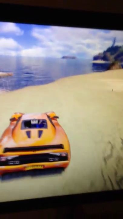

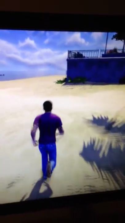

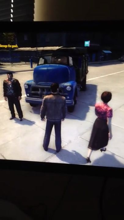

I bought a 250Gb Samsung Evo from the MM here a couple of months ago and installed it into the PC in my sig...
I've had an odd stutter that has happened ever since and have since tried all sorts, Overclocks/ Bios updates/ Drivers etc etc
I created a thread (2500k load line calibration) as I was unsure as to whether this was the issue, some very helpful people gave many good suggestions but none really worked, then I jumped into the 'Official 7950' thread and LTMatt hooked me up with a couple of his custom BIOS's, It seemed to get better but It's STILL doing it :(
I've just slapped in the old HDD and booted from that into windows and ran a few benchmarks and stress tests etc and it wont stutter which leads me to believe the SSD may be buggered or corrupt.
If you could take a minute to watch the following videos that would be appreciated :)
Thank you!

Nothing else spikes as such. only the frame rate as it drops to nothing momentarily.
