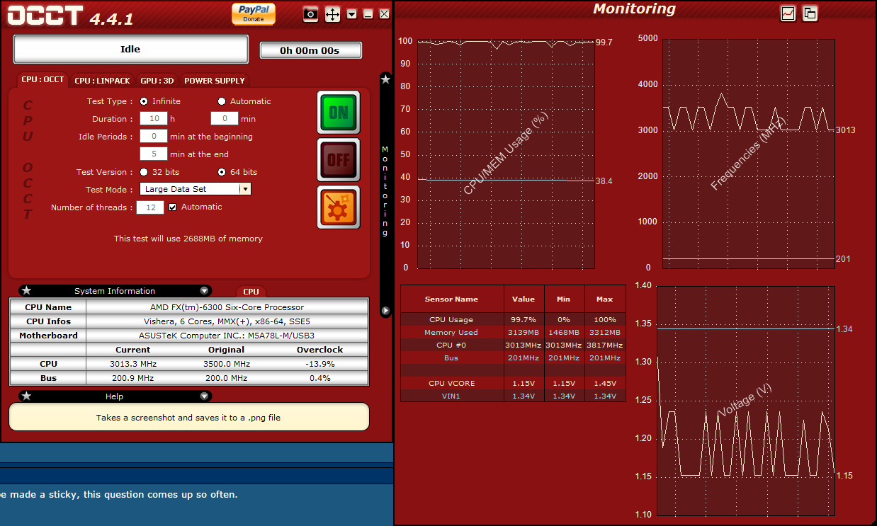

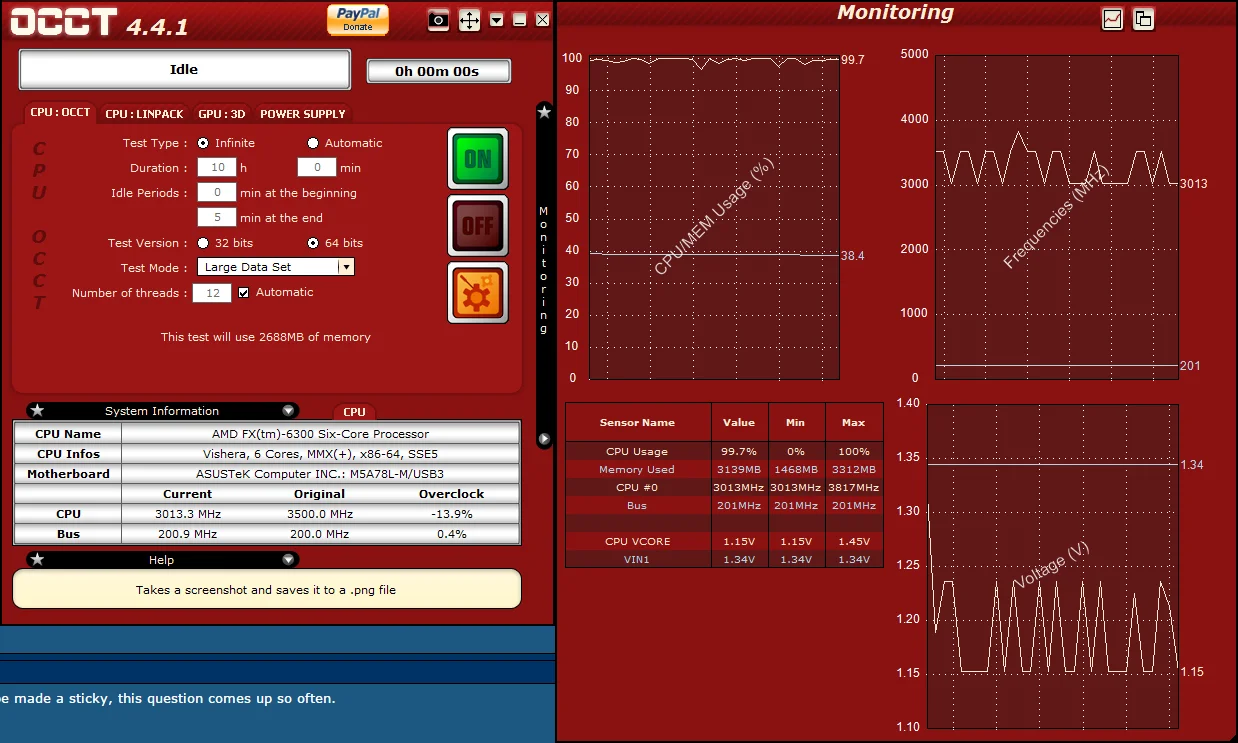

Hey OCUK, wondering if someone could help me out. I'm having problems with my FX-6300 processor. (spelt wrong in post title soz!)
Basically my VCORE and CPU Speed seem to be dropping all the time always from the stock 3.5 ghz down to 3.0 ghz.
All settings in bios are stock defaults, windows is in high performance mode etc. I've tried disabling c&c or manually setting speeds but this fluctuating always seems to happen :(
Specs:
  • AMD Piledriver FX-6 Six Core 6300 Black Edition 3.50GHz (Socket AM3+) Processor - Retail
  • Asus M5A78L-M/USB3 AMD 760G (Socket AM3+) DDR3 MicroATX Motherboard
  • Samsung Green (MV-3V4G3D/US) 8GB (2x4GB) DDR3 PC3-12800C11 1600MHz 30nm Dual Channel Kit
  • OCZ Vertex 4 128GB 2.5" SATA 6Gb/s Solid State Hard Drive (VTX4-25SAT3-128G)
  • ASUS AMD 3GB 7950 gfx
I've attached a pic from OOCT below with the graph of what's going on, I've confirmed the drops in CPUZ too btw.

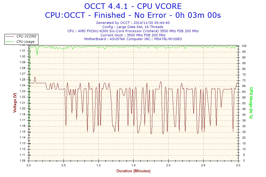

The VCORE fluctuates between 1.08 volts to 1.45 at times though! It's very weird. This is all on default settings.

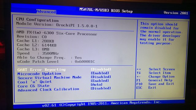

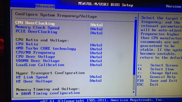

can you provide us pictures of your bios settings,

Bios screenshots attached to this post.
Disabled turbo core, still does the same thing.
With regard to switching to x35 multiplier, I assume that means changing bus speed down to 100 mhz? I'll give it a try though and see how it goes!

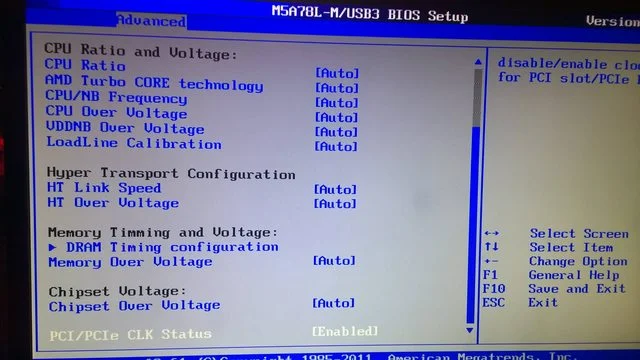

Change your loadline calibration from auto to something just below the highest. Or put it on highest if it still messing you about. Loadline Calibration is something I feel could defo sort your issue out. It's a powerful feature, without it my 4 phase board couldn't stay on 4.5GHz stable for more than a minute. Also, manually put in the CPU speeds, Northbridge values etc. Some boards like to screw about when on auto. And disable PCIE overclocking, it's not worth the risk and there's no performance to gain from it. On auto your mobo could be playing about with it.
In fact anything with auto on it try to manually do the correct values. Memery defo should be set manually.
None of that worked for me unfortunately! Even with everything manual set, LoadLine at 100%, still getting drops at all speeds :/

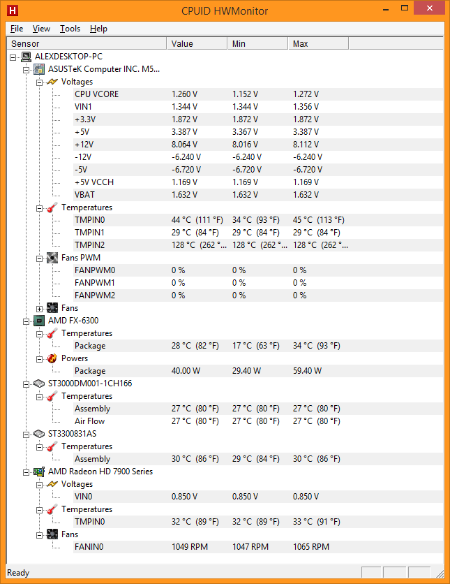

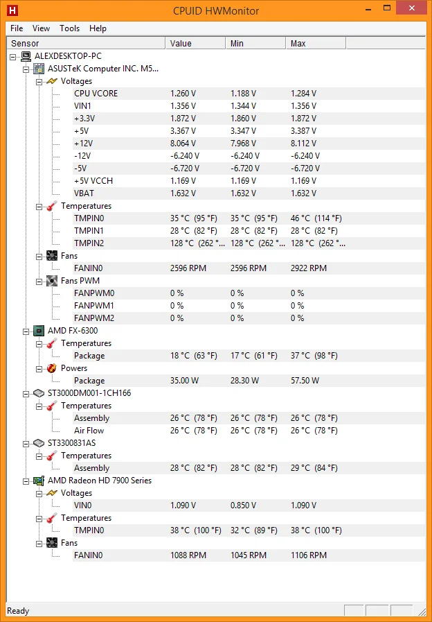

With your turbo core off and cpu multiplier set to 35, could you confirm a few things for me please.
When testing could you provide the occt screenshot like before and a screenshot
Of hwmonitor.
I'd just like to see that your v-core is maxxing at 1.25v, and that it's not hitting excessively high with llc on. Also to see what your cpu speeds are hitting, and all temperatures.

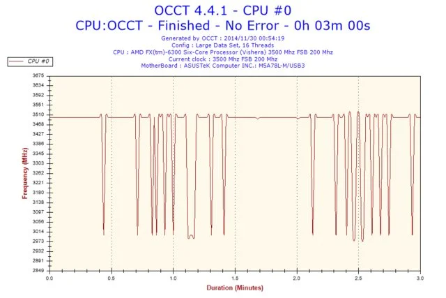

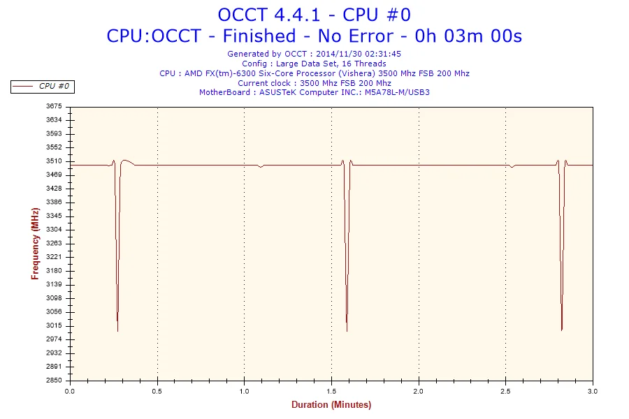

Test 1:
LLC: 3.25%
Voltage: Auto
Turbo Core = Auto
Fan Speed: Auto (Not 100%)
Multiplier: Auto (200 MHz)
Ratio: Auto (x17.5 3500 Mhz)
Test 2:
LLC: 3.25%
Voltage: Auto
Turbo Core = Disabled
Fan Speed: 100 % over 40 degrees
Multiplier: 200 MHz
Ratio: x17.5 3500 Mhz
Test 2 Extended (thought it might be interesting to show graphs when not stressing too)
Test 3:
LLC: Auto (48.375%)
Voltage: Auto
Multiplier: 200 MHz

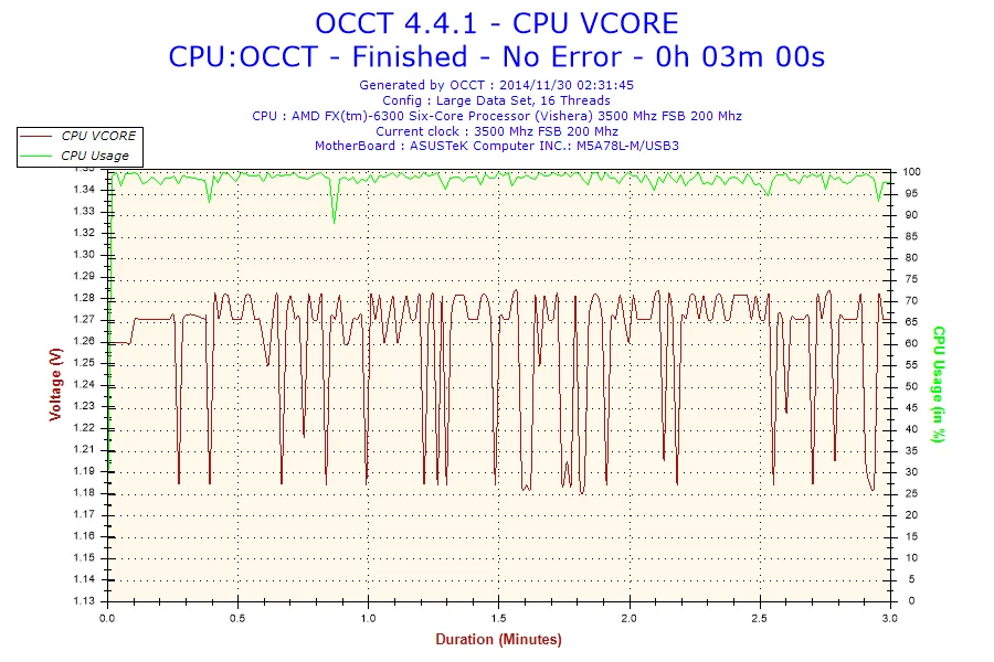

Notes: Temperatures strangely low for this one! Same readings in AIDA
Test 4:
LLC: 90.3%
Voltage: Auto
Multiplier: 200 MHz

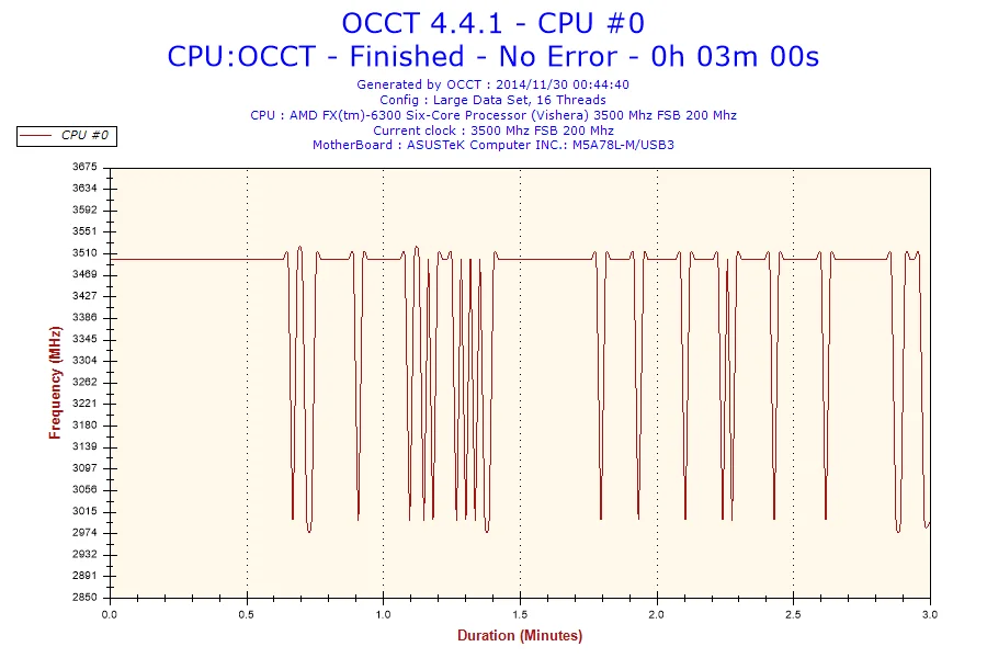

Test 5: (as suggested by Davedree)
LLC: 0%
Voltage: 1.2
Multiplier: 200 MHz
Notes: PC hung once for a few seconds during the test.
Thanks very much for all that data, so thorough and perfect!!
This thread should be stickied for future 4+1 phase victims.
Well test 1 confirmed the cpu tries to hit 4.1 ghz with 1.48v, then reduces through it's p-states and lowers the voltage accordingly to 1.31v, then 1.21v.
You can thank Amd for their excessive unrefined voltages for this.
From your hwmonitor tmpin0 = (cpu temp) and package temp and cpu v-core readouts, it can be seen that cpu temps are healthy. Vrm temps aren't provided by Asus for this board. It's clear that the vrms are overheating as posters advised.
There's a couple off things we can try, I noticed in the bios section (advanced) there's a cpu over voltage option, set that to disabled.

If it still throttles then as we knew this board is a pooper as you can't turn the throttling feature off and 1.20v isn't asking much, We really recommend you get a better board, because there's so much potential you're missing out on due to the cpu throttling at 3ghz.
Back in xmas last year I experimented with an fx8320 and a gigabyte 78lmt usb3 matx which has 4 phases and apm mode, I successfully pushed the fx8 to 4.5ghz @ 1.45v to which in prime 95 it would eventually throttle. However benching or gaming I could manage 4.8ghz without throttling. If you're interested here's a link,
http://www.overclockers.com/forums/showthread.php/741906-Rgone-you-should-like-this-more-to-come
Well it certainty did it a lot less Davedree! (I've added it as test 5 to the previous post above)
The voltage is still all over the palace, no where near the 1.2 I manually set it to, but it's dipping a lot less for sure.
