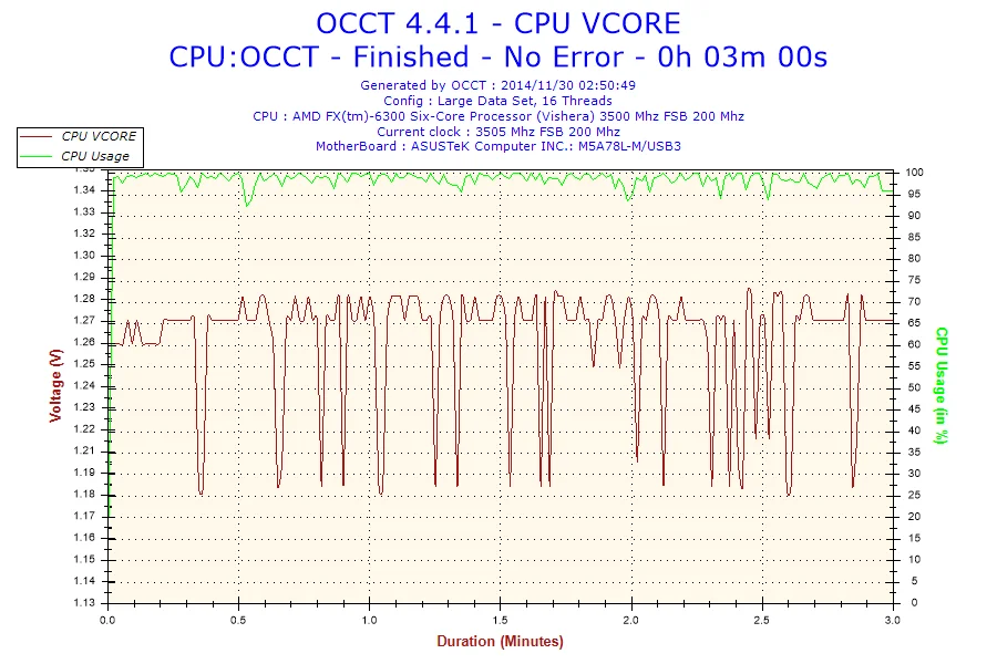

With llc on you are over working the vrms and phases harder, so they will heat up quicker, With it disabled you reduce the workload on them but suffer v-droop but it's not a problem unless you want to push big clocks.
Yeah problem is you're still hitting 1.28v, we need it down to 1.20v ideally then i reacon there won't be any throttling, then on the other hand another board could get you to 4.4ghz or more.

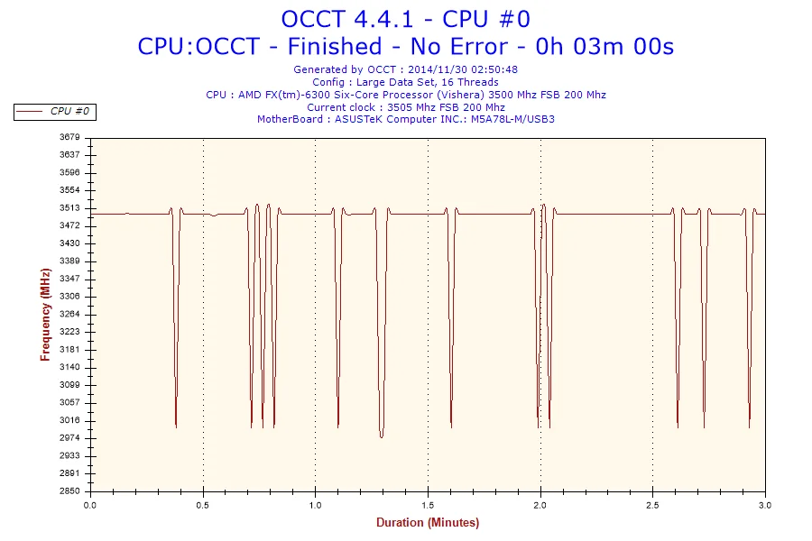

OOCT reporting errors with current settings now! If I'm aiming for a lower voltage does that mean I'll have to underclock my cpu to get it stable and not fluctuating in speed?
Also, just re-did test 5 without errors and gettings big drops like before, damn this motherboard! Will try a fan now if I can squeeze it in.
Re-done test 5:
yeah your hanging is not enough juice for the cpu, and we're already 300 mhz down from 3.8ghz so don't want to go lower than 3.5ghz
I reacon get the voltage upto 1.225-1.3v and try gaming or the things you do normally.
prime 95 occt and test programs put an unrealistic load onto the cpu, where most apps and games don't push it so hard
Well, 3.5 is the stock speed, I'll monitor in games etc though and see how it goes. (have re-done test 5 and posted in prev post btw)
