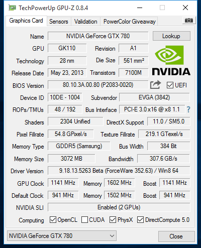

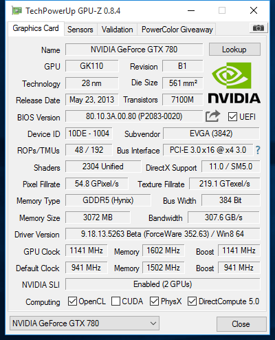

I'm running 2 x GTX 780s (EVGA SC)
On a Z87X-OC board. My PSU is an Antec 1200w HCP.
Switching the PCI-E slots is not easy as its in a waterloop. I have pulled each card out individually, and just rested the PCI connection on the tops on TOP of the PCI slot on the motherboard, so only one card is plugged in, and its runs perfect having tested both on their own
I believe this is more to do with software, drivers maybe that physical hardware faults. Because on their own the cards perform 100% fine.
