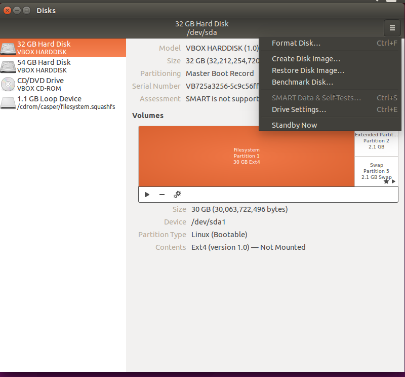

Tried Linux boot disk but doesn't look like System -> Administration -> Disk Utility is available in 'try' mode so I tried to use terminal but from what my limited linux knowledge could tell, it was only checking my SSD.
Press the windows key and search for Disks
