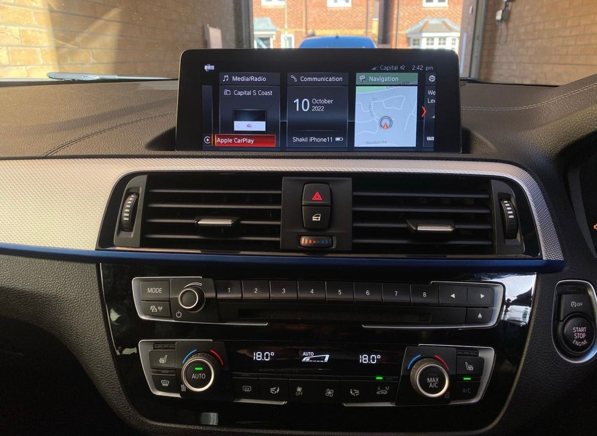

Right next question..... CarPlay. Anyone had experience of it retrofitted into an older car? Currently the option is not available on the Mrs car. Ive had a quick google and it seems it can be done with a screen and wiring change to the headunit. Ive seen one from a brand called RoadTop. Again I dont have a clue here but the wife really liked it in her old company car so she really would like it again if at all pos
You can get the proper OEM version of it retroffited by a competent installer. Someone like GAretrofits can wire it and code it properly.
I'm sure you can find someone local who can do similar, they also occasionally travel up and down the country. :)
