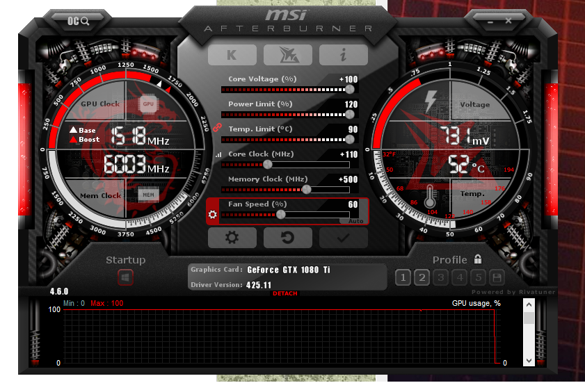

Okay so when playing games such as Fallout 4 or AC: Odyssey I'm averaging around 70 - 80fps on my current settings at first. Then at some point, may be 10 minutes in or 2hrs my 1080ti will suddenly hit 100% usage and the game will turn into a slide show at around 20fps or lower.
I've got minimal tasks running in the background, have made no recent changes to the system. I have DDU'd my drivers and it makes no difference if I run the card at stock settings or with my custom profile which is/was stable (110+ Core & 500+ Memory). Temperature on the card never goes above 80c even at full load.
I've a 9900k at 5Ghz which isn't breaking a sweat, highest cpu temp so far has been 74c. I don't know what's going on and could really use some suggestions.

Is my current profile with seemingly more scope to push it a bit further... Will check out the m.2 issue but why would it be happening a different times? If the gpu is putting out a consistent temp while in use.
So my nvme drive hasn't gotten higher that 60c according to HWinfo, GPU was again 100% during the last 30mins or so...

So I may be on to something after picking the brains of a friend earlier... GPU Memory clock maximum 6000Mhz minimum 375Mhz according to HWinfo. Now I'm not sure if this is happening when the frames drop or not yet but it's something to keep an eye on through afterburner in real time. Hoping it's something simple.

Is it something duff on the card then? Not sure how to force it to keep the memory clock up...

So my problem continues...
I suspected it may be anti virus software causing issues as I'd seen a massive dip on gpu memory clock, so I uninstalled bit defender and thought this had solved it. However it's doing it again.
The only thing I can find in hwinfo this time is that CPU core 1 & 3 have hit a minimum of 800Mhz at some point, the rest remaining around the 5Ghz mark with little fluctuation. No temperature spikes or anything. I wouldn't mind but I've even lowered my setting again and have gone from around 90fps to 22fps in games with no changes made, game has been running for about 4 hrs though this time before it happened again.

dip in memory clock... only thing i can think of is fault memory controller/ ram chip on the GPU card .. they can fail, rare - but if you have i recording or VRAM speed decreasing then increasing should help fight for card RMA testing
