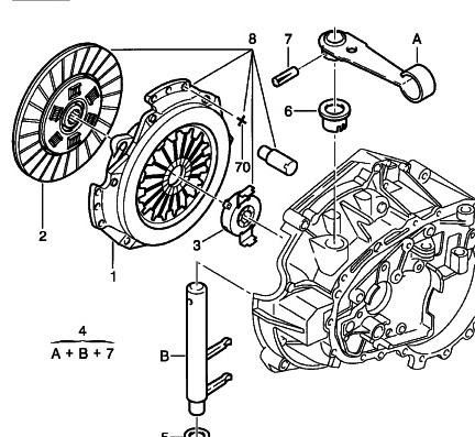

replacing all of the clutch should probably cure it, there was wear on the spring forks ? that wear would mean the bite point would raise, making it less likely to disengage fully.
