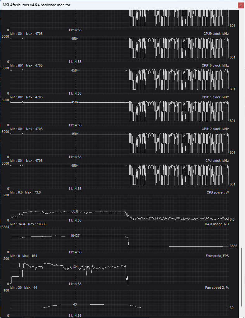

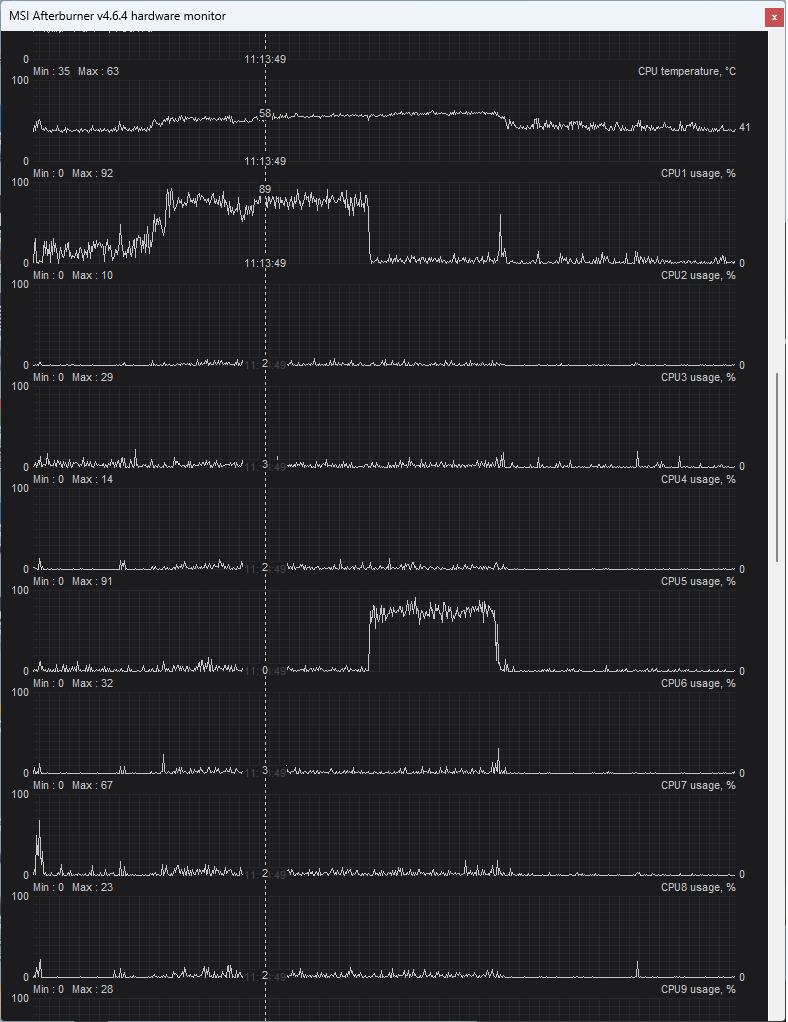

Does this help?
It looks like a single CPU thread is being pegged at about 90% and the GPU slightly less. So I suppose the game is not multithreaded and is limited by CPU clock speed rather than overall ability (core count not helping here).
You could experiment with your clock or boost settings, it also does look RAM heavy as Joxeon says.

Everything regarding temperatures and clock speeds looks normal from your charts.
