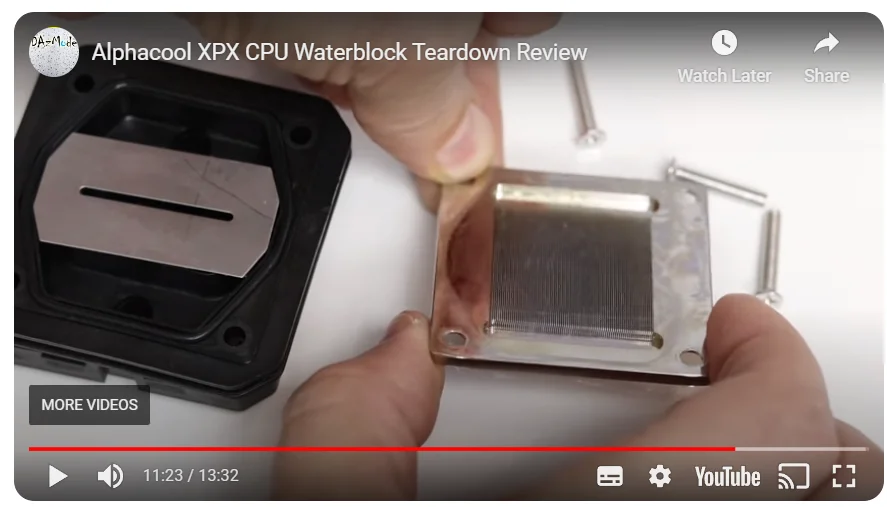

With this type of block it is important to get the in/out correct and even the orientation can make a difference.
The water is pushed through the slot to impinge in the centre of the fins, it then flows to the sides and exits.
The slot in the block should be alighed with the CPU die, water is a poor conductor of heat but a good carrier so it's the impingement that maximises the heat transfer.
From what I can see a line drawn from the in to the out port should be parrellel to the socket lever... but that's just from looking at a few pictures and a delid so you may want to confirm.
Seems I can't add a video at specific point so image here:
Video - image at 11:23
Orientation is correct including inlet and outlet. the inlet and outlet are marked inside the block thankfully.
