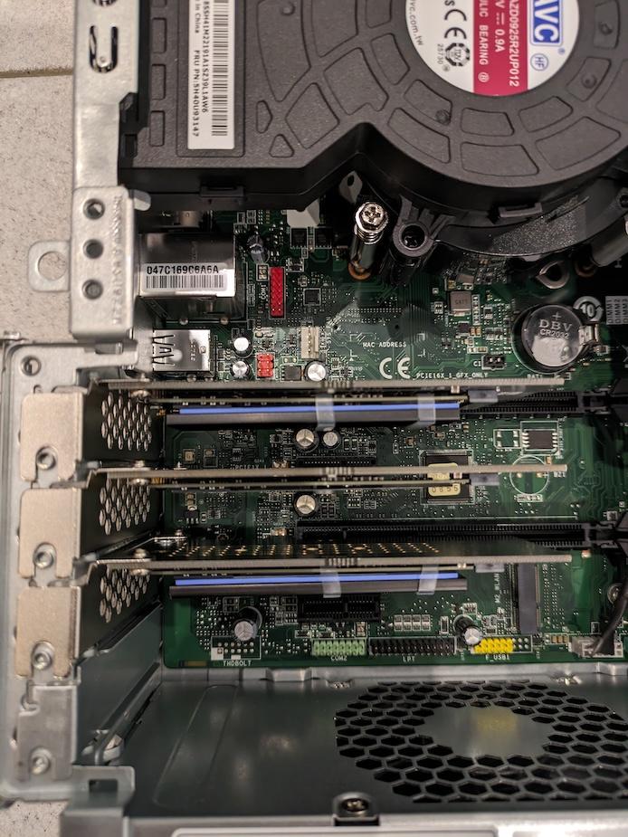

It will go in one of the 2 large PCIe 4.0 slots in the photo below, and the NVME in it will move to the slower spare PCIe 3.0 x 1 slot. Everything is half height cards.

The PC itself is not that fancy either, as you can see from the photo! Pre built Low power-ish Lenovo desktop.

What sort of machine are they going in, if its a normal desktop, an x8 card is going to rob your GPU of 8 lanes of PCIe typically, you may not want this, depends on what you do with your PC.
You may be better served with a later PCi gen x4 card, though it is fair to say I ran the 8x Intel dual nic in an x4 slot with no 10G performance issues in my use, well apart from when it overheated and would drop to 1gb but that's another issues.

Nothing fancy
The other PCIe slots are used to add extra NVME drives so I have 5 NVME and 2 SATA ssds in total for storage. CPU is i5-12600 with Intel HD 770 and 32GB RAM. More than sufficient for downloading files and hosting a Plex server. No Gaming or photos/videos etc. I generally never hear the fans and the whole thing uses about 12w at idle and about 25w when viewing content. So I want to keep the whole solution of adding a 10gb NIC low power/noise/cpu etc.

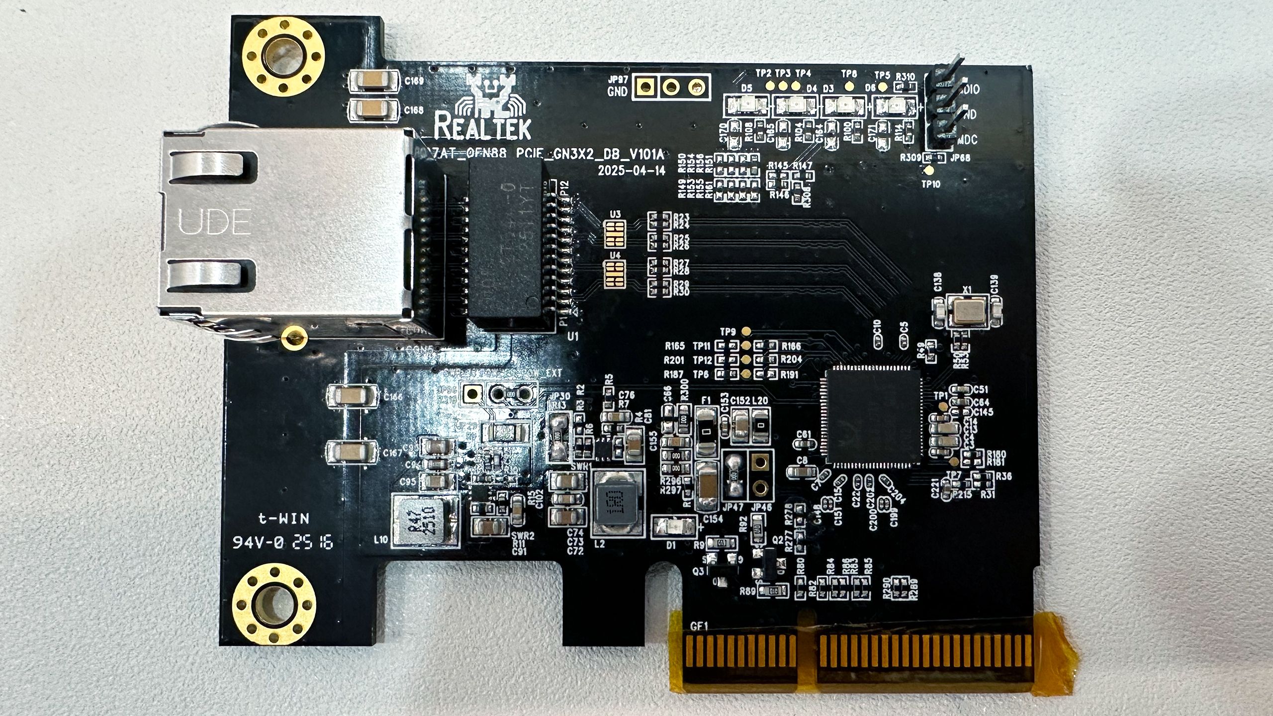

I read that Realtek have some new chipsets that have just come out that do 10GB at really low power. Not much info as they are new, but I ordered one on a punt for 32 euros from china.
Even lower power draw than the Marvell ones, and about 10 times less than the Intel ones!
