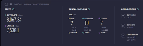

In the end I got both the Realtek 8127 and the Marvel AQC113. Both run fine albeit I had to fiddle with the power saving in the drivers for the Realtek to get it to work. No real power draw difference that I could tell tbh, maybe 1w difference, but it's quite hard to test.
