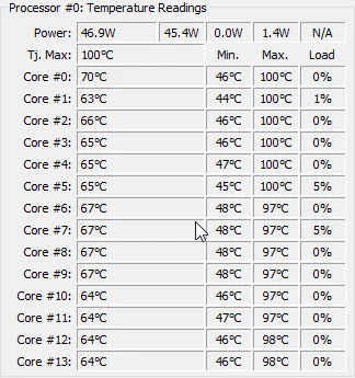

Not used to seeing high numbers, so i'm just putting the feelers out there, playing WZ2.0 right now and i'm seeing this, also whilst playing they can be around 80-100. which is my main concern.
is this something to be concerned about, or are these temps normal with this CPU's i'm using Arctic Liquid Freezer II 240
In the picture they're around 60-70 which is fine for a gaming temp, but they shouldn't be 60-70 when you're idle (which you appear to be), so that suggests something is wrong.
What program is that? Is it updated?

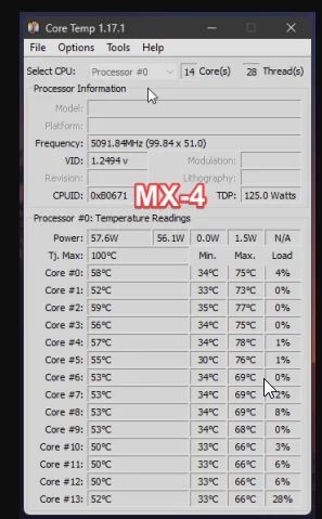

sorted it out! too the cooler off and clearly didn't put enough paste on! slapped some more on and now getting these result!
Glad you sorted it, but I'd be using a different program to verify, if I were you. Core temp was last updated in April 2021, over a year before your CPU launched. It does say "preliminary alder lake support" in the changelog, but still...
