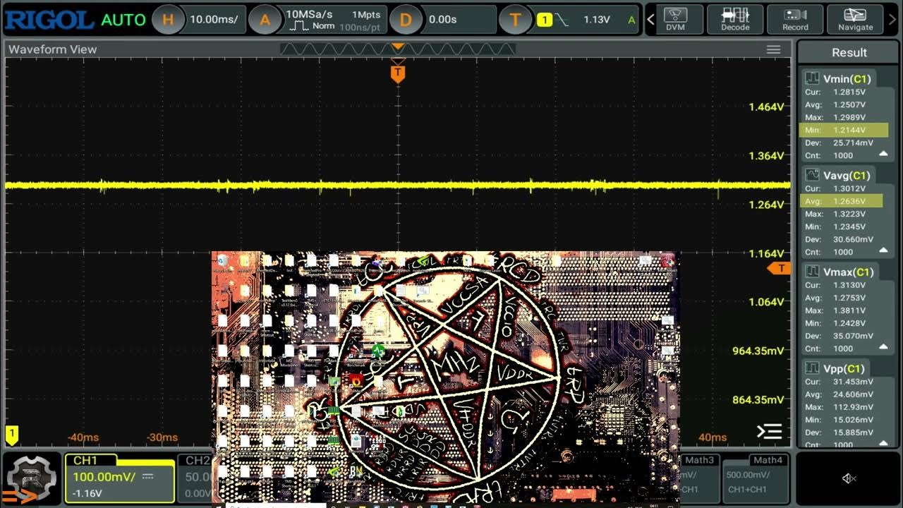

Buildzoid seems to recommend higher LLC levels in this video to reduce idle voltages and this is the motherboard I am using.
My understanding of what he is saying in the video, is that when you're using a static voltage, the lower levels of LLC lead to the board having higher drops, which means if you want to maintain a higher average voltage at load (which is important to OC stability) then you have to push up the static voltage.
If you use a higher level of LLC, then you can use a lower static voltage (which gives you lower idle voltage), because the level of drop is lower at load, which means the overall stability is better even though your idle voltage can be lower than at lower levels of LLC.
He clarifies that even though higher levels of LLC potentially push more voltage overall (at high load) to maintain a stable average, this is not important for short benchmark runs, because the VRM can handle this fine (especially when you're not scooting around the desktop and causing frequent load spikes), but you probably wouldn't run a high level of LLC if you wanted to spend 5 hours rendering.
