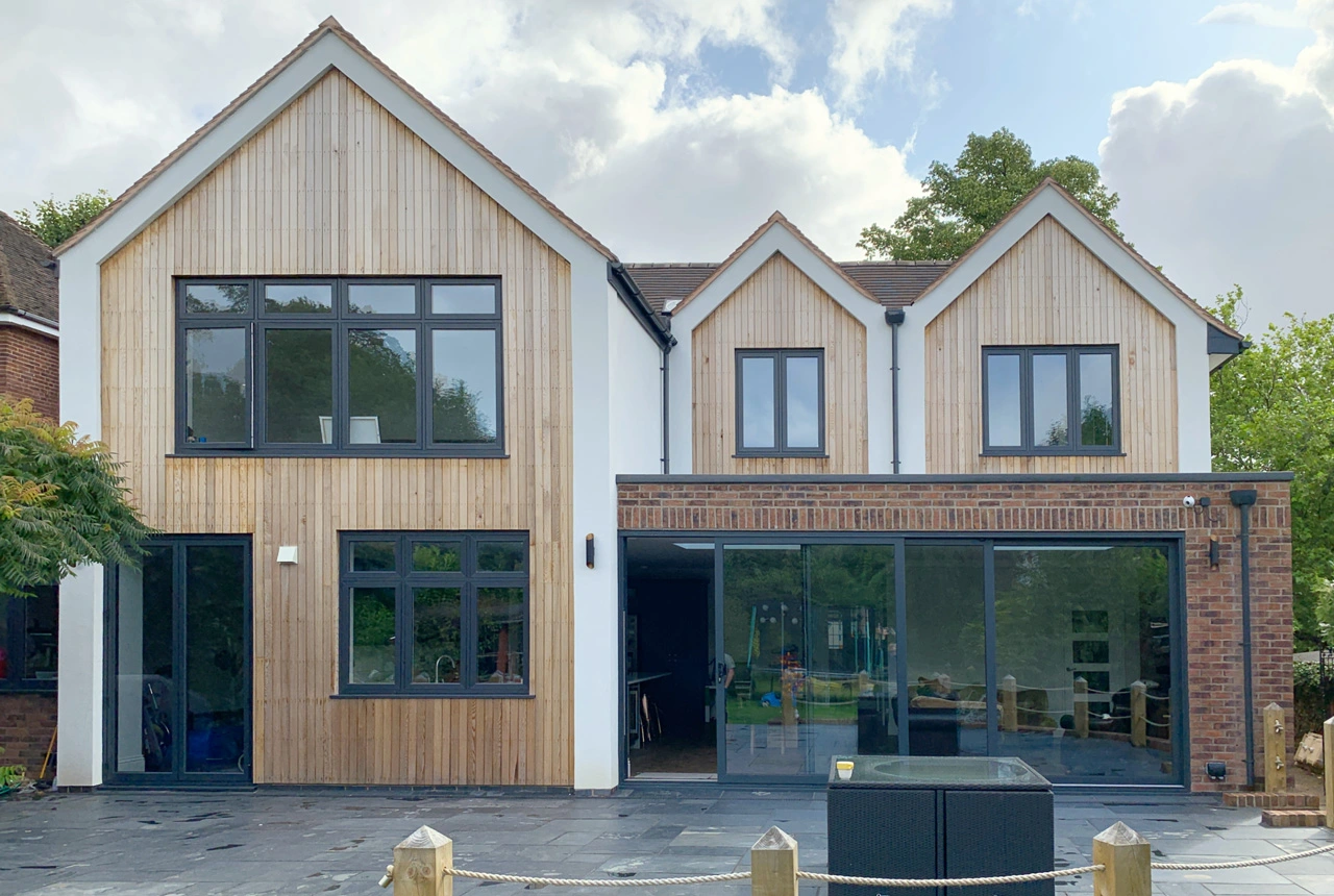

If it makes you feel better these 2 steels and another interlocking steel to connect fireplace was 15ish k! (plus bifold install). I'd watch out for really low prices as you get some morons installing them terribly with poor temporary propping and consequently joists /houses dropping, door frames twisting etc..)
I hadn't realised you did this work yourself, I thought it came as you've been posting it! £15k is a tough bill to swallow but I guess that is the price you pay for quality. I think those doors would be the answer later on for locking off the space (y).
