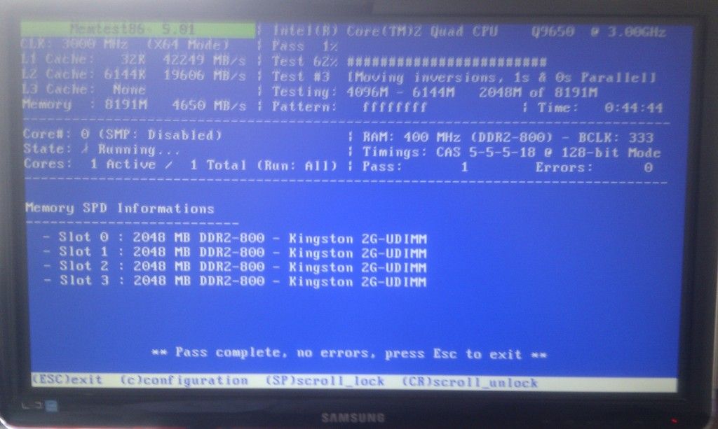

2) Then I installed all four ram sticks and ran Memtest 86+ Ver 5.01 and my ram successfully passed one loop of all 10 tests without any error. Attached is the screenshot. So from this perspective, ram was working all fine.
