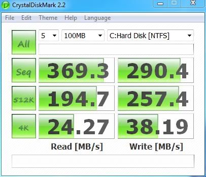

Ok with the two value drives in raid I got the following in Crystal Disk Mark
Seq Read 374.4, Write 86.27
512k Read 303.9, Write 87.37
4k Read 23.13, Write 71.46
4kQD32 Read, 213.7, Write 85.73
Do these numbers look ok?
Cheers
Fred
Reads look very good and higher than I had with paired Raptors. Can't remember right now what my write speeds were. Unfortunately I sold my Raptors and replaced with an SSD but I'll see if I have any old benchmark logs kicking around. What controller you running these on? Off hand, I seem to recall my reads were around 250 MB/s and writes around 120 MB/s or so. That was with 64k strip size on Intel ICH10R onboard.
OK I have some recent benchmarks of a VelociRaptor on same system. The striped Raptors were faster of course so looks like your reads are slower than expected but it will vary depending on what controller, driver, and strip size you are using. Can't argue with those blistering reads though. Bloody Hell!

I'll ask the friend I sold my Raptors to if he can run some benchmarks on them and I'll post them up when I get a chance. He's striping them on an Adaptec Host RAID controller card but it will give you a rough comparison.
Those numbers I mentioned have just come in. 2x Raptor RAID0 on Adaptec Host RAID.
Sequential Read : 139.392 MB/s
Sequential Write : 162.595 MB/s
Random Read 512KB : 51.875 MB/s
Random Write 512KB : 123.567 MB/s
Random Read 4KB : 0.903 MB/s
Random Write 4KB : 3.179 MB/s
Like I said it'll vary depending on the setup but don't think there's much wrong with your array.
I have always used 64k, but you will find arguements for all over the internet, I always thought that 128k was a little big, but some people say that they dont notice a performance benefit unless its 128k.... swings and round abouts
Stelly
I think 64k is as good a number as any if you are unsure or can't be bothered messing around and rebuilding arrays in order to find the best strip size. I've found the 128k to be slightly better for secondary volumes but we're talking about miniscule differences in practice anyway.
I've got my array set to 128k, simply because OCZ recommended 128k for stripe size on their forum.
