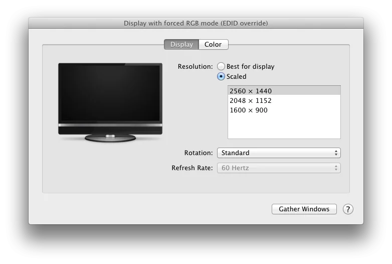

There is a problem inherent in OS X that makes it think displayport monitors are actually TV's which means it then displays a different colour space and sharpness. To resolve this issue you need to follow this guide here to force the RGB colour space. If you go to system profiler and look for your monitor it may say it's a television and cause issues.
http://ireckon.net/2013/03/force-rg...ix-the-picture-quality-of-an-external-monitor
I went through so many adapters and while the dual link dvi was good, i didn't like having this bulky adapter which took up a USB and also it costing £50 was a bit of a pain. I'm now using a Mini DP to DP cable and it's perfect when using the hack above. It only cost £5 too instead of £50.
I think this is the problem Tweaker is having above. It's a digital signal so cost of cables is irrelevant.
EDIT - As you can see in the image below, OSX assumes my LG 27EA83 is a television instead of a monitor and displays a different colour space instead of RGB. This is with a forced EDID override now.
