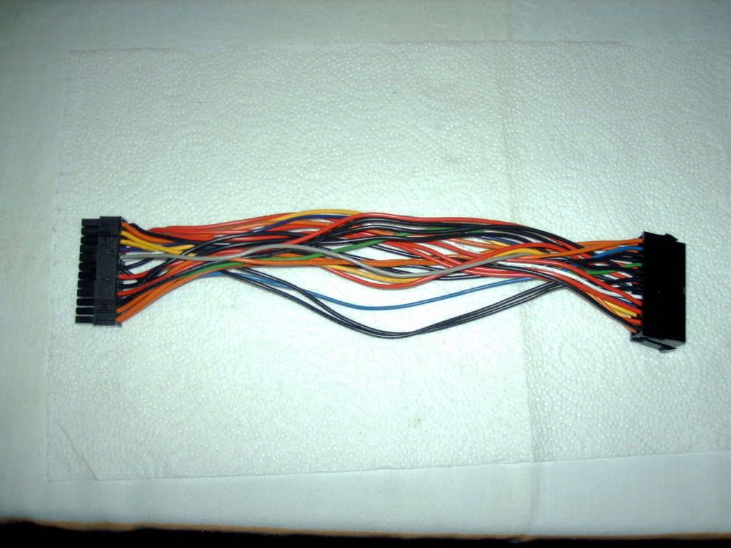

I was just about to have a go at braiding my 24 pin extension, and fell at the first hurdle. Getting one end of of their socket , using the staple method, is fairly easy. How do you get the other end out?
Also when ever Ive seen braided extensions the wires go straight from one plug to the other. Mines just a mess, wires crossing over themselves. It seems as if one end is flipped 180 degrees for no reason. If I take all the wires out of one end cant I just put them into their correct socket and have the wires going straight?

Thanks guys , I think I have it sorted. I couldnt figure out what the problem was and why i couldnt depin 1 end , so I cut the top off a 4pin extension to see what I looking at better.
It turns out the the Sumbeam ATX extractor tool isnt long enough to reach into the pins. Now using a flattened paper clip and all's well. Am I glad I spent £12 on the proper tool for the job. In fact all 4 tools in the pack are fairly useless.
And now its daylight I can see there are little numbers stamped onto the plugs so its easy, 1-1, 2-2, and so on. Thanks for your help.
