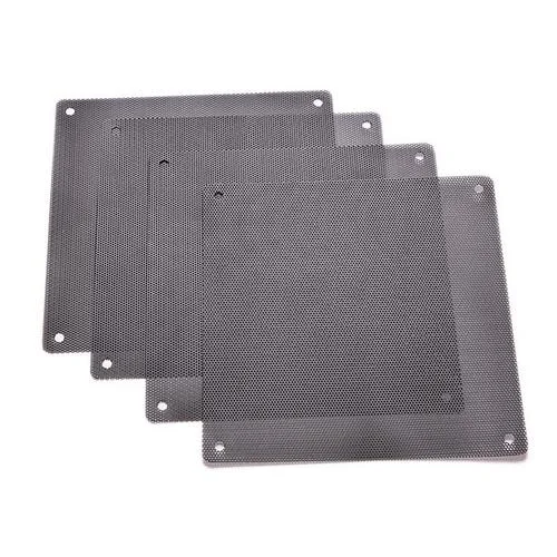

Yeah but then the fans are there to touch. Have young kids so can't have it like that .
You can pick up some mesh filters for the fans for a quid or so each, like these:
Will improve air flow dramatically, will still look good, and you won't have to shell out for a new case along with all the hassle of rebuilding.
