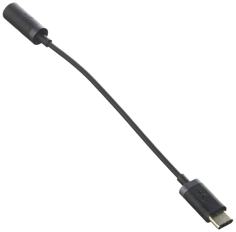

Don't actually know if this exists, have been searching amazon for a while and only find USB C adaptors to let you use 3.5mm jack headphones with a usb c device.
I'm looking for the reverse, so i can use the USB C headphones with a normal jack output ... Would this work and does such an adaptor exist?

It does not necessary do that.
I have a Moto Z2 Force and the adapter is just that, and adapter (no little box in-between), it takes an electric signal from the USB pins and it sends the same signal though the 3.5mm jack to the headphones.
Sure most of the ones you can buy contain a DAC but that would be no use to me as the Phone contain the DAC in my case and it does support 24/192.
So I see no reason it cannot be the reverse but would no doubt be hard to find as most have an inline DAC.
