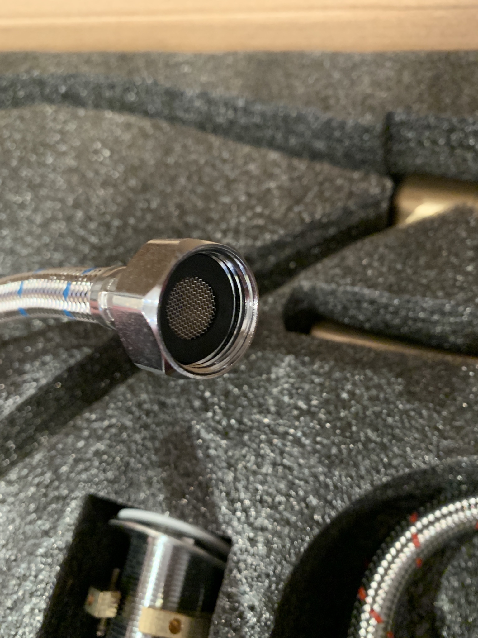

Here we go guys, pic of new tap
And pic of one of the hose ends:
Measured across, it's 22mm.

Those are 1/2" female connections (they measure 22mm but they're not) you need 2 x 15mm - 1/2" male irons.
These
https://www.screwfix.com/p/compression-adapting-male-coupler-15mm-x/69358
Or these
https://www.screwfix.com/p/hep2o-plastic-push-fit-adapting-male-coupler-15mm-x/5970f
Or anything else that goes from 15mm pipe to 1/2" male iron.
Don't think so, the 15mm part is the copper pipe size, the 1/2" bsp is the threaded side.
Copper pipe sizes are right but bsp sizes don't match the size they're called. No idea why.
Edit, read that wrong last night, if you're connecting to 15mm pipe you'll need a 15mm fitting. The OD of the pipe will be 15mm so that side is easy to measure.
The imperial bsp fittings don't match up though, so a 1/2" fitting doesn't measure 1/2" OD. I did see a chart once that gave the correct measurements for the different sizes so that would be helpful to find the correct size fitting.
Once you know what fitting is needed both sides then you can find one to fit both, yours being 15mm - 1/2" male.
Occasionally you'll need a couple of fittings to do this but you can get most combinations in 1 fitting.
If you've been doing it long enough then you just know what fitting you need by looking at them.
