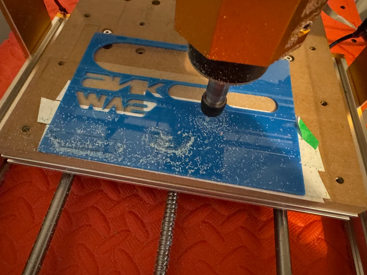

Annnnd.. The first CNC error. Again, it was human (IE, me :D )
I set the black huge piece down in Easel and resized it to what seemed like quite small. In reality it was over 250mm wide, and a A3 sheet of acrylic is only 210mm wide :D As such after the first hourly check I could see immediately it was wrong. Thanks to this hourly check I saved a piece of acrylic, as had it started making its way up above "SPECIAL" I would have then not had enough.
That meant going back to the drawing board and making it a size that will fit. TIP - if you are working on a specific sheet material size then resize your bed so that things appear in correct scale. Had I done that in the first place I would have wasted 0 materials, as the issue would have been immediately apparent.
Any way, that job was to take over 5 hours. I wondered why it was so long !. It's now down to about 3 and 3/4 hours. Again I will check it hourly, but the immediate action seems much more in line with how it should be.

Will up some pics later. Decided to cut all the pieces for the logo with a 0.8mm bit running slower. It made a huge difference on the GECK.

Well it seems I should have enough blue to finish the top logo. So I loaded it up and it’s running now. Should be done around 5:30. The yellow is all done too.

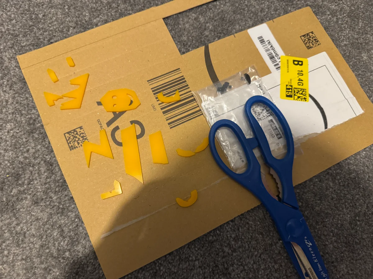

OK pics. First up the yellow parts of the jigsaw. In the baggie are the black tiny inserts for the Neo and Geo faces.
Will bag it all up later. The blue is underway.

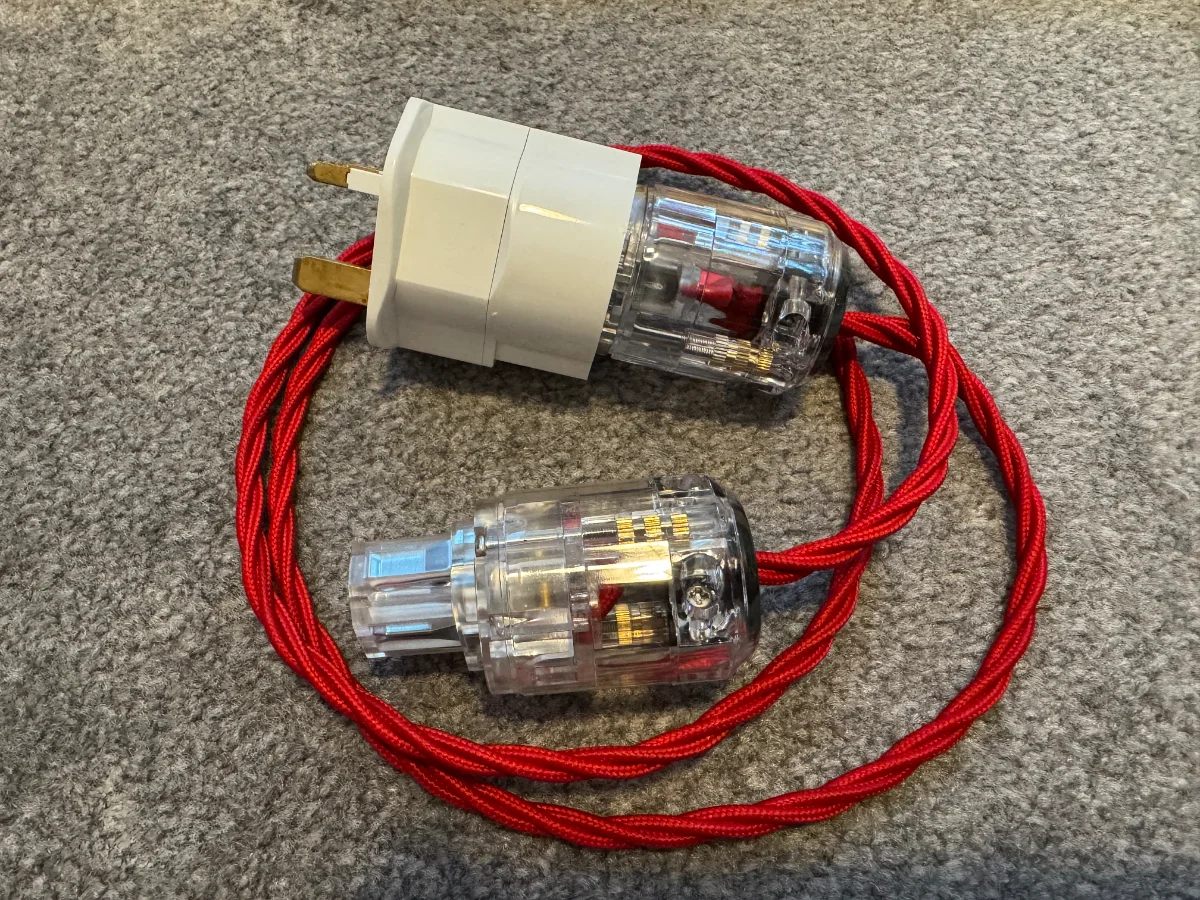

And my gratuitously over the top power cable is made. To prevent putting the euro one in the wrong way around I’ve glued it into the UK adapter shell. Now I know I know, things like this aren’t really necessary but it cost sub £15 all in and looks amazing.

Also please note that the braided cable I’ve used for the power IS NOT sufficient or safe for use on a PC. A PC with a 1000w PSU for example could easily overwhelm the wires. In this case though? It’s running a 5v 5a PSU that’ll never draw anything near 5a. I’ve also fitted a 3a fuse to be sure.
You're bucking the trend there. Tradition seems to say that you should slap a 13A fuse in a 'kettle' lead* despite the connector only being rated to 10A, completely ignoring what's connected to it and even what guage the wires are! †

* Yes, I know they're different...but colloquially and for simplicity.
† Lest there be any doubt, this is not a safe thing and a fuse should be chosen based on all the above criteria.

So there are three small blue pieces absent. I didn’t lose them…
When you import an SVG into Easel it sets every piece to “machine out a pocket”. IE - turn into tiny pieces of dust. I realised this with the features in the Neo and Geo faces and cut them again. I didn’t catch it on the blue pieces.
No biggy it’s a 10 minute job.

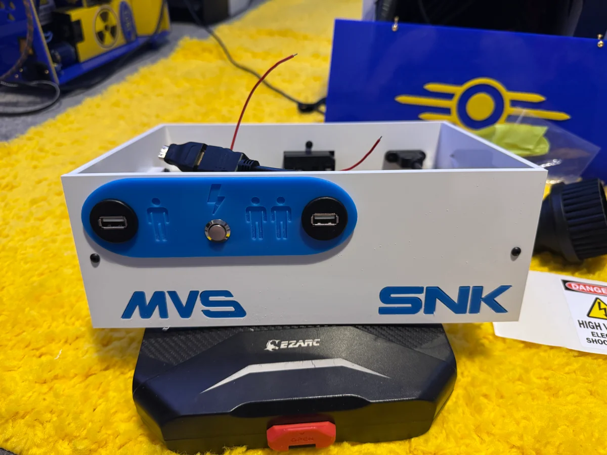

OK finally got around to drawing the top and bottom. This will be the bottom. I have designed it to look like a CRT screen.
The art is also finished. Will get a pic of that later :)

Sadly the HDMI port patch does not work. How irritating :( it did when wiggled, then packed up completely.
The rest though does work and I can confirm the pad works beautifully with a Pi. Ugh what a pain. Glad it’s only two screws to remove the top tbh!
