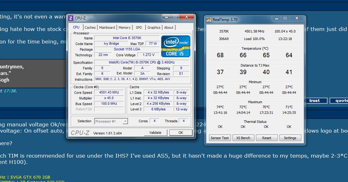

Agree with this. I'm sitting on 1.280vcore on 4.5Ghz and here's my temps running my cpu 100% all day. I'm fully stable, but going to/over 1.3vcore I get 80c+ and usually want to avoid going there for 24/7 100% use. Temps increase a bit when gaming, but that's fine as I don't game all day, so hitting high 70s for a few hours is alright.
Strange thing to note is I set the vcore to 1.280v but it showed up as 1.3+ on cpuz and I only got it down to the value below by lowing the igpu volts (IMC?) to their min. Make sure to put the igpu clock freq down as well and this helps with temps.
