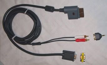

Are you using the VGA cable to connect the 360 to the TFT? The official VGA cable comes with left and right phono plugs for the audio and also an adapter to convert them to a 3.5mm stereo audio jack.
See this image:
Well I will be, I have not purchased it yet, but if thats the case I can at least get 2 chanel sound :)
Yeah you will only get stereo out of it unless you happen to have a digital decoder around, your speakers only accept individual channels as the decoding is usually done by the sound card in your computer. Some speakers can upmix a stereo signal to 5.1 (virtual) though but those are normally the ones with the built in decoder.
