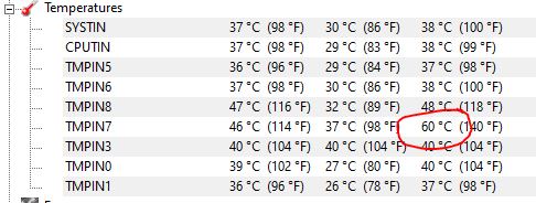

3600 temp spikes when idle.
26 Feb 2004
4,874
Hampshire, England.
I know I'm not alone here, the Ryzens are known for it, right? One of my core temps seems to spike a lot higher than the rest when idle and it's messing up my otherwise 'silent' and manageable PWM fan config in my bios...
Any tips?
I have the same thing on my CPU..
And what im lead to believe is that the AMD CPUs do idle higher compaired to Intel..im sure someone will be along to help more.
Not a lot you can do, it's the nature of the CPUs really. They boost to high frequencies quite often to respond to demand of what you're doing or background OS tasks, each time it boosts it does produce heat in a small area. You can't really compare it to Intel systems as they work so differently, a high temperature doesn't mean it's using tons of power.
You could always add a slight delay to the fans ramping which means it shouldn't spin up on short idle spikes.
Step up delay is what it's called I think and usually set to 0.1 by default so increasing this should make the fans less sensitive to short spikes.
