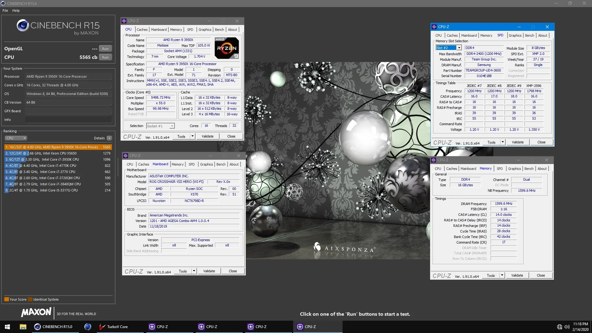

Mine is running at all core 4.3ghz with 1.30v
Hello there!
I am currently running it 4.4ghz on 2 ccx and 4.3ghz on the other 2 at 1.3625v
I get 11500 multi on cpuz and 440 single, is that acceptable and sustainable?
