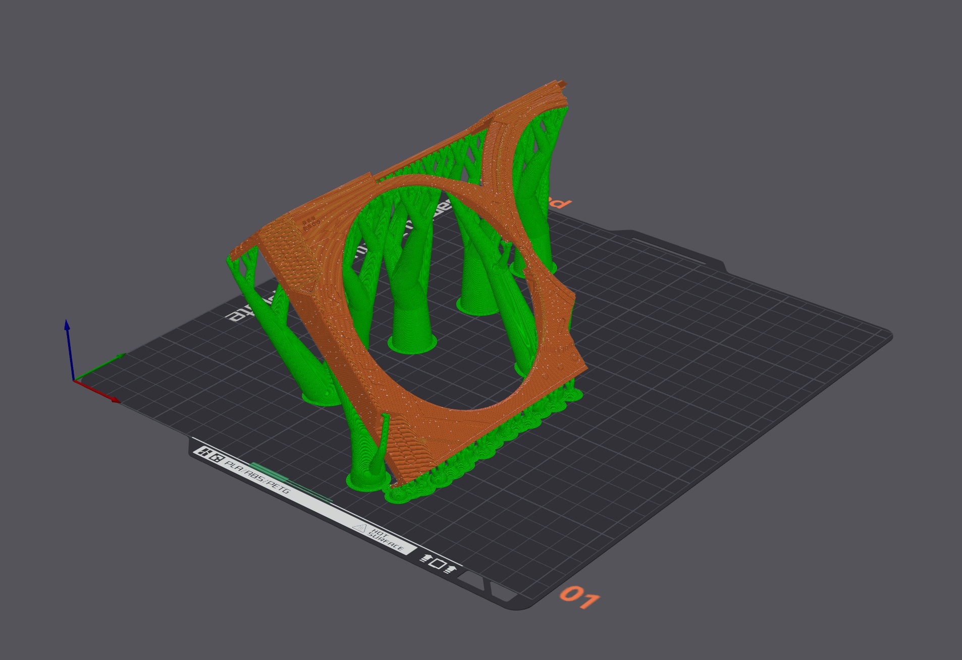

I just printed it that way up with auto tree supports. It may come out better if it was angled. Something like this :
I'd go the other way up tbh? that notch in the top should be better facing down rather than trying to print that edge in the air.
I was thinking about doing them face down it's a pretty fast print time that way. I'm not too bothered about losing detail as it won't be seen anyway but the supports underneath look like they might be a lot of work to remove.
