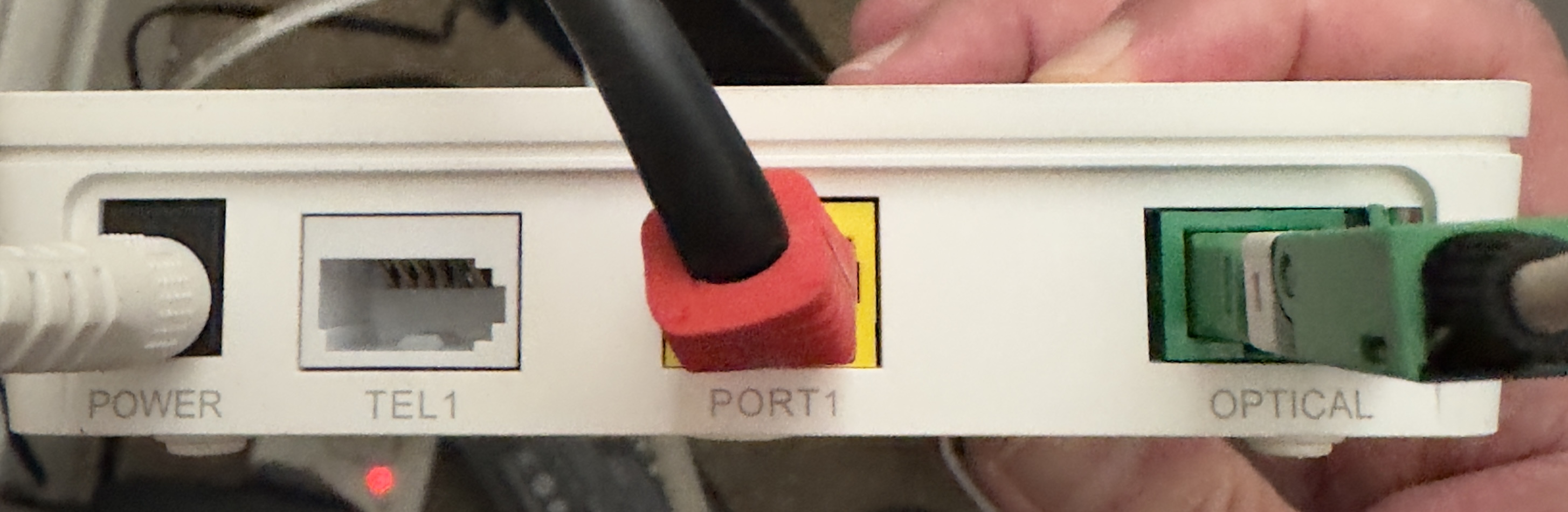

Hi
My current ISP is EE and I’m looking to swap out their router for a 3rd party one. However, after trying a TP-Link VDSL modem/router combi that didn’t work I’m confused as to what I need.
I don’t have a DSL phone line so couldn’t connect the TP-Link to the phone outlet so I tried connecting WAN to WAN on the Openreach box but couldn’t connect to the internet. I’m sure I used the correct username/password (I believe EE username is the one that starts with PRODUCTIONXXX).
So I’m a bit lost as to:
- What type of router I need
- How I should connect and maybe what settings to use
so would appreciate any advice.
These are the connections I have on my Openreach box:
Did you follow these two articles?
Although I don't see anything on the product page that specifically calls out FTTP.
That first article is interesting as the instructions included in the box didn’t mention half of that.
I still have the TP-Link boxed back up waiting to go back to Amazon so I may give it a go using those instructions first and see if it works.
