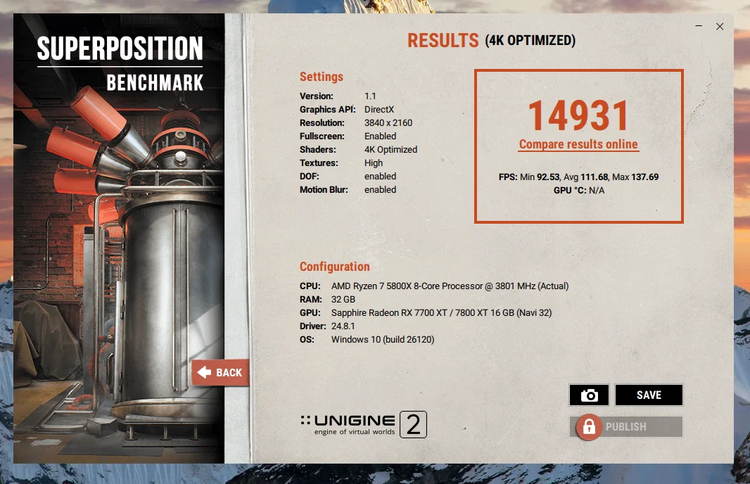

OK just for you and since I have half hour to kill I re-ran superposition at stock (4k optimised) and undervolted. Ambient room temp 26 degrees.
Here are my results:
Undervolted
Score 15961
FPS min 76 average 117 max 144
Temp min 43 max 67
HWINFO reports 73 degrees hotspot with 172watts used max
Stock
Score 15579
FPS min 76 average 116 max 146
Temp min 41 max 76
HWINFO reports 91 degrees hotspot with 280watts used max.
Conclusion - running at stock uses 63% more electricity, runs 25% hotter and produces a 2.5% worse benchmark score, with essentially the same FPS
By the way you owe me a fiver for the extra 108 watts the card used for running that test :cry:
Undervolted
Score 15961
Temp min 43 max 67
Stock
Score 15579
Temp min 41 max 76

Superposition is a 7 year old benchmark. Run Breaking Limit https://www.gpuscore.com/benchmarks/gpuscore/breaking-limit/ and come back to me.
