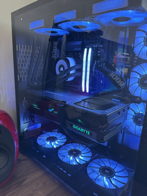

I think I've cracked it. Not even sure I need something like this yet (MSI 5080 Gaming Trio coming tomorrow hopefully), but this seems to be exactly what you might need in my situation....
Side back on! Think I would have preferred the cable to go the other way but couldn't find stock of that type. I'm replacing the PSU soon anyway so it's only temporary.
