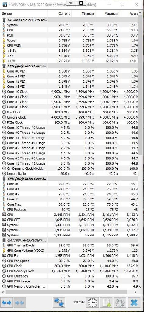

did a load of testing seeing how far i can push the R9 390 now i got 4.9ghz. was going to try for 5.0 but thought what is 100mhz really going to give me
ran real bench 30 min stress test.
Temps%2030%20mins%20Stress%20test_zpsmgtr36wg.jpg~original

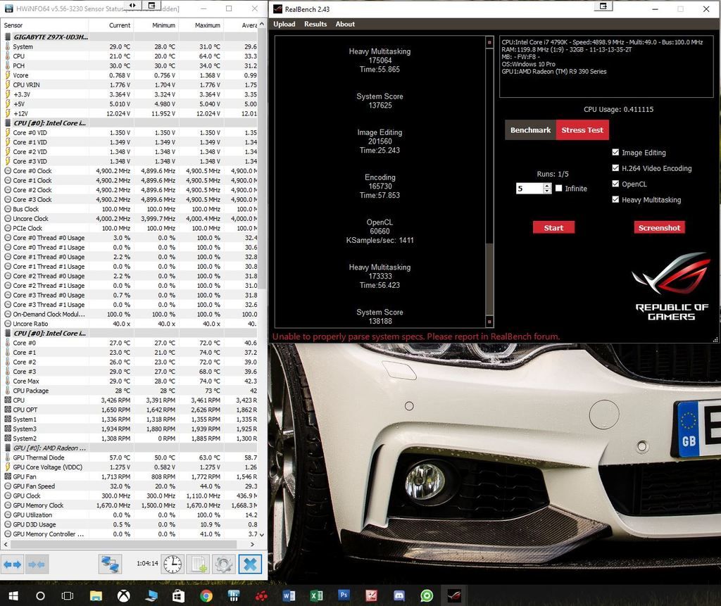

then did a 5 x run through on real bench
bench%20mark%205%20x%20run_zpsf8uppgox.jpg~original
Yeah i wouldnt bother with 5ghz unless if just for benching as youll need over 1.4v i think i needed 1.42 or something, bit much for every day use. What cooling you using btw? i noticed you said you had a rad so im guessing gpu or cpu is water cooled. If your gpu is water cooled you can probably up the voltage a bit more, if you really wanna push it with a bit of bios editing or a flash with a high voltage bios, i think i used to run my 290x's at about 1.35v. I wouldnt go any higher than the stock bios if your on air though as some of the air coolers dont cool the vrms.
