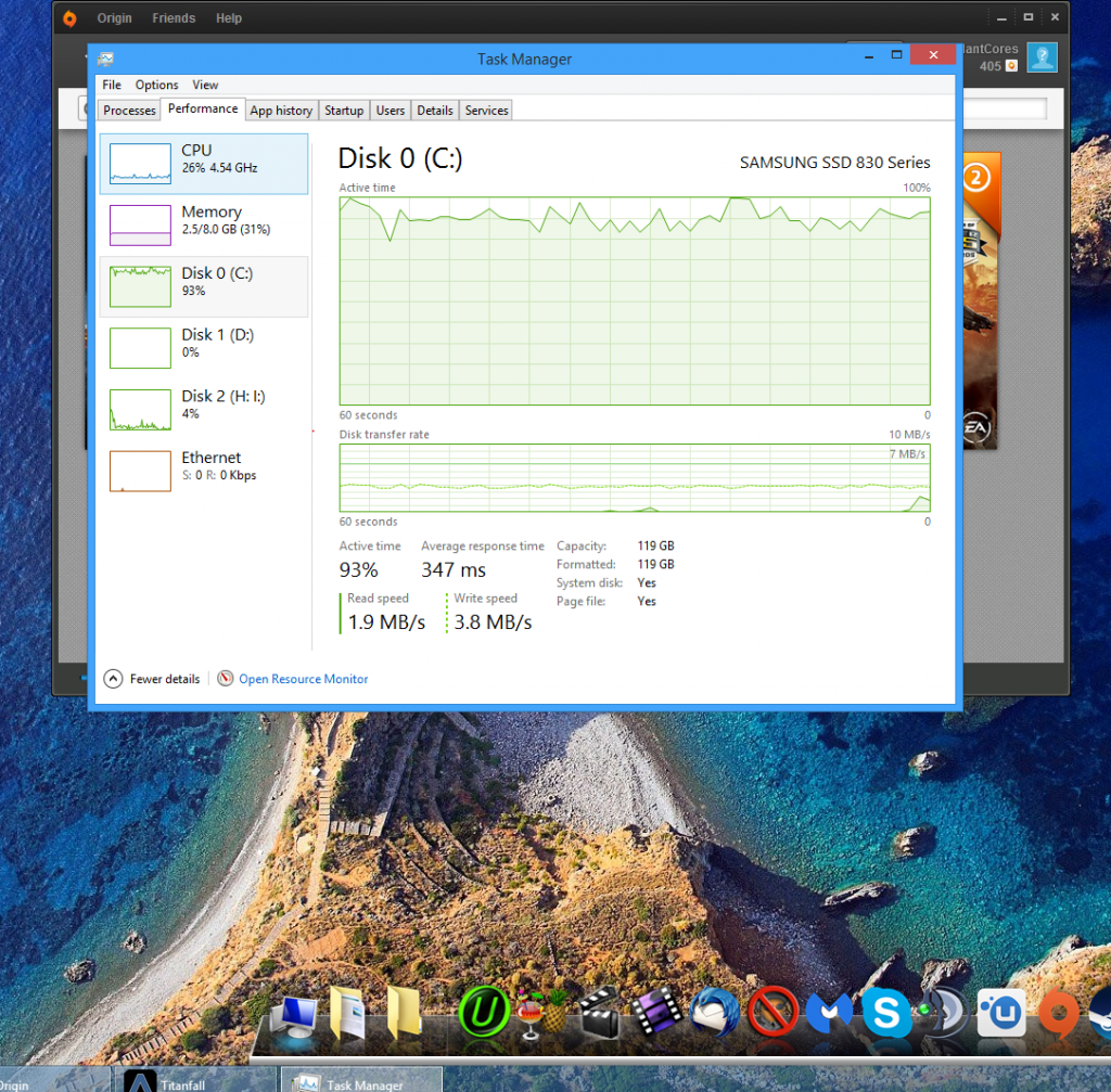

I just DL'd the 48 play for free to test the game out before buying it, however, i can't play it, serious problem with it.
The game will launch by stutter along at 1 FPS with extreme input lag, i figured out why.
Drive C is running at full when the game is running, see pic.
Its not even instilled on C as its an SDD with limited capacity, i have the game installed on a mechanical drive, like many others.
I have checked the game files in Origin ecte... all seems ok and yet it will run like this...
Please help, 48 hours access, if i don't get this fixed soon it will expire before i get to test it.
Thanks

http://i1056.photobucket.com/albums/t364/Hunbug76/TF_zpsbfe9fb36.png
What's the capacity of C: before you launch? If it's creating some big temp file you might be able to find it with SpaceSniffer and from there google what it is.
Its a 120GB Samy 830 with 20GB free space.
I got it working, i closed MSI AB and Gaming Evolved, i restarted Gaming Evolved and its still working, have not tried it again with MSI AB yet.

Don't know, i thought it might be, had mine set to 2Gb, set it to 6GB and it was still kaput, its only when i closed MSI AB and Gaming Evolved that fixed it, i have since restarted Gaming Evolved and its fine.
After starting MSI AB it all went to poo again, closed it and its fine.
Its defiantly MSI AB (4.0.0 Beta 9)
