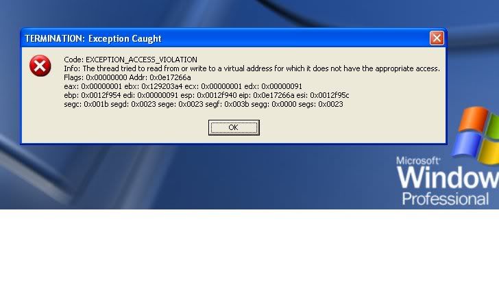

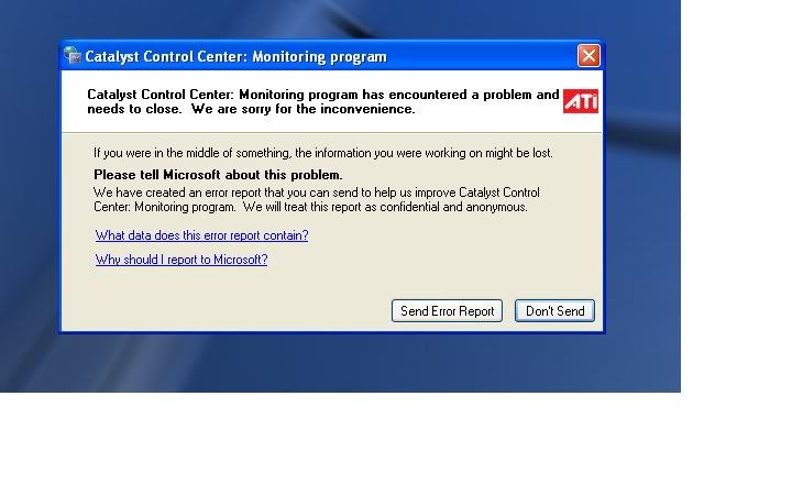

tried installing the latest drivers, now every time i boot i get this error screen...
only 5 days in and already a hat full of problems with this card, serioulsy have second thoughts about ATI
Tried unistalling and re-installing but this error keeps coming up!! ARGH!!!!
plus my system now fails to complet even a simple benchmark like Augamark3!! when I run it i get this error.
