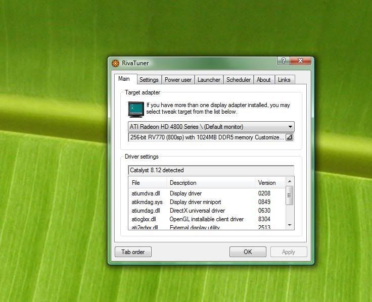

How can I use rivatuner with this card? I dont get any overclocking options at all, all that sort of stuff just isnt there!
Worked fine with my 8800GTS, and I'm using v2.22 which supports the 48xx series cards :(
Works no probs with mine. same combo 8.12s & 2.22
Tried a reinstall of driver & rivatuner ? have you just switched cards over ?
Rob
As far as I know you need to disable driver signiture checking for it to work under Vista 64. You might have done this already. If not then it may be worth a try.
Works fine for me under Vista 64. Same combination of drivers/Rivatuner too. Sure i did'nt turn anything off either. Apart from UACS anyway.
this is what i get, frustrating!
Umm.. see the little triangle where it says "Customise" click on that and go to "Low level System Settings" thats where the overclocking tools are.
