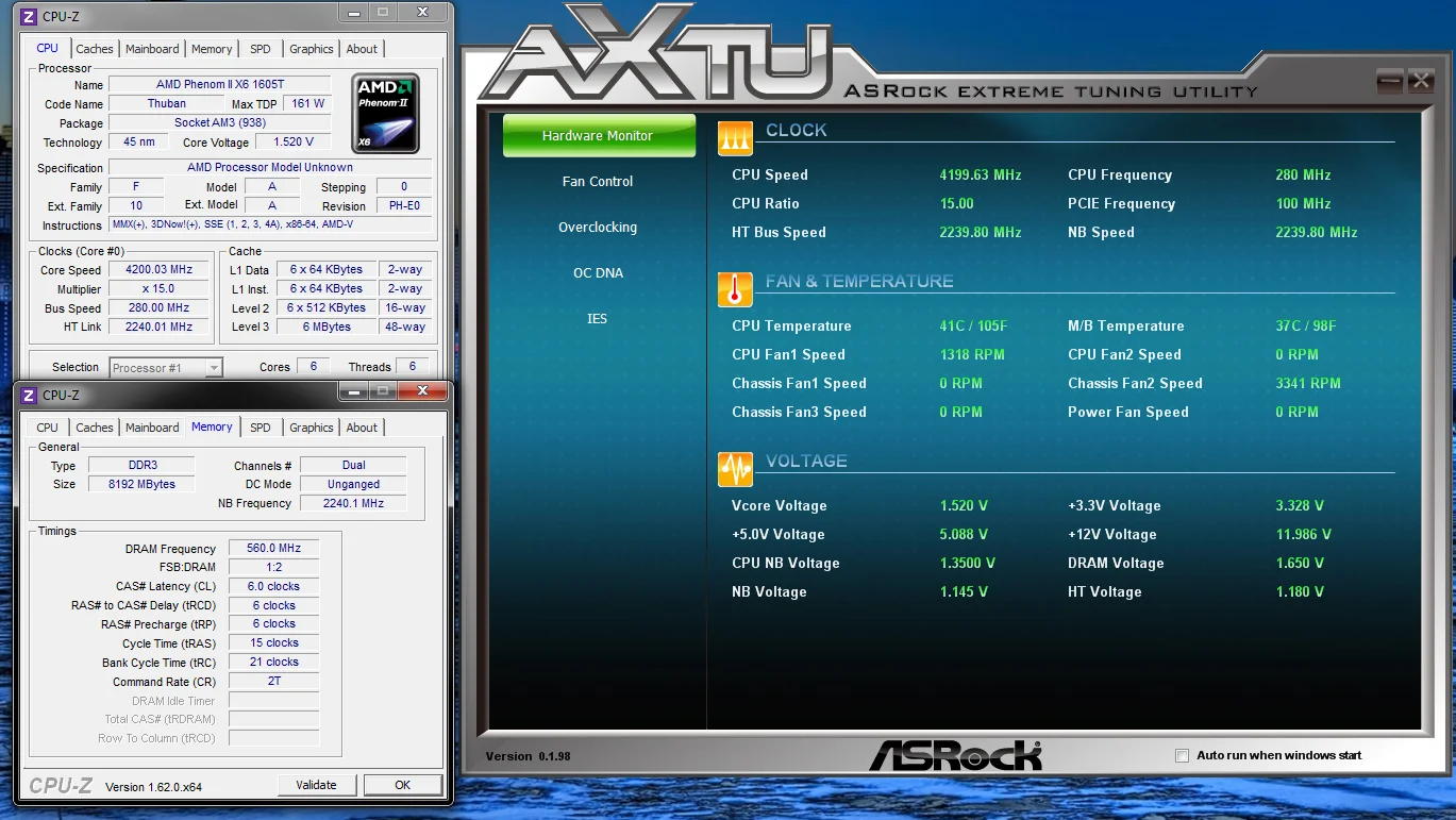

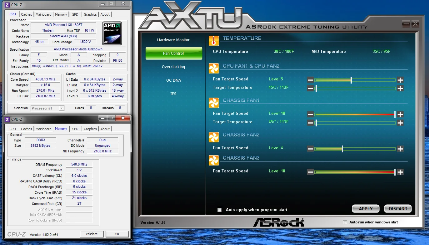

This is what i've managed to get.
I used the Asrock Auto OC as a guide. It originally set my Vcore to 1.550. Which is the max for the chip. But i lowered it to 1.500 and it seems to be alright.
Changes?
Ill have to give it a go a bit later on, my bios went a bit dodgy and reset and i cant seem to get it to the same level.
The max voltage of the chip is 1.550v, the 4.2GHz at is a bit unstable at 1.52v. Im not too sure how close to the max voltage i should go.
Ive been keeping it at 4.05GHz at 1.52v for the time being, ive seen people say they've gone higher than max voltage, but i dont want to push it to much. What do you think?
