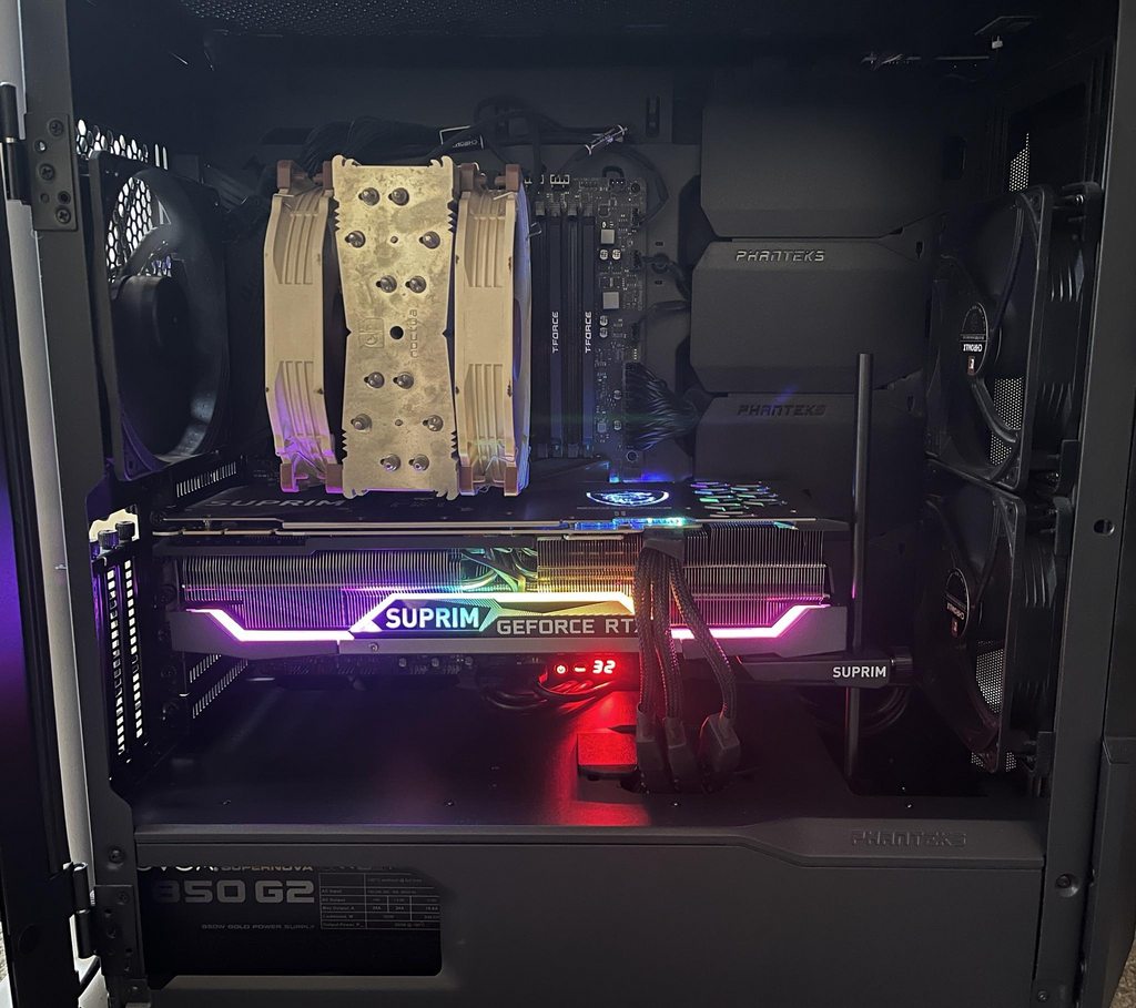

I have the Noctua NH-U14S with dual fan (in push-pull) I can highly recommend it if you can find one for sale. It's currently using a low noise adapter and the 3 Noctua case fans are locked at 42%
I looked at the D15 years ago and it looked too big for my case at the time and/or might have caused issues with memory clearance. As you can see, the front cpu far sits just behind (~1cm) the RAM
Also had an AIO years ago but it was one of the first (Corsair H50 I think it was) the pump on that thing was so loud and annoying that I went back to air not long after buying it
Here's my setup with the 5800X3D
That’s some fan! I think I’d be pretty close to my memory with that also
