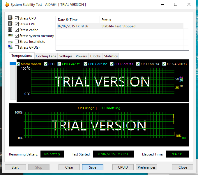

So, hitting a little itch here.
System is stable ( i lowered clock down to 4.5 for now to find out what's causing this to happen )
As you can see in windows the system is stable and happy to run at the speeds it is set at.

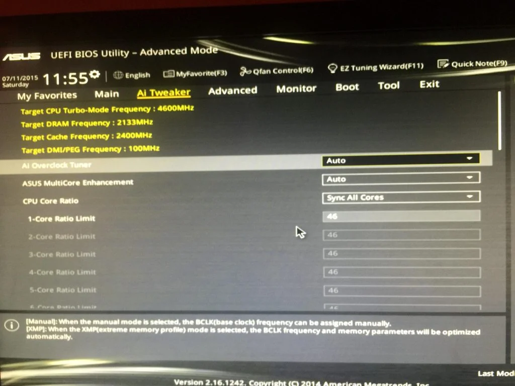

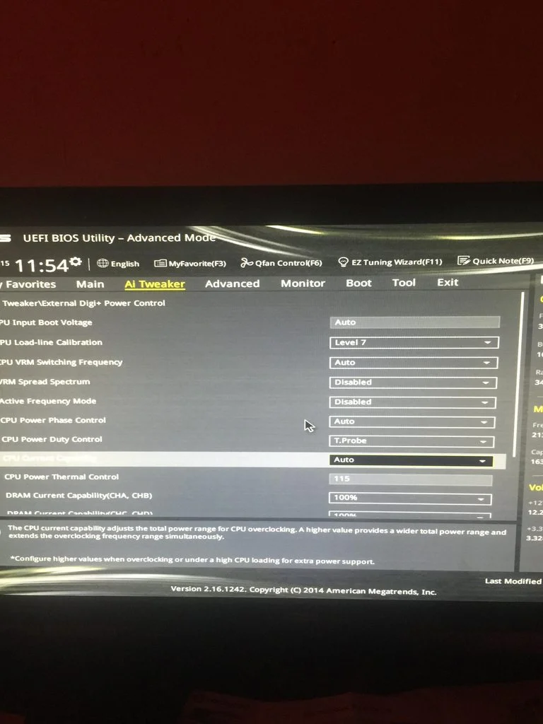

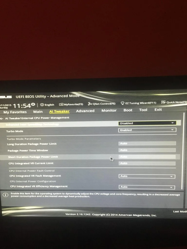

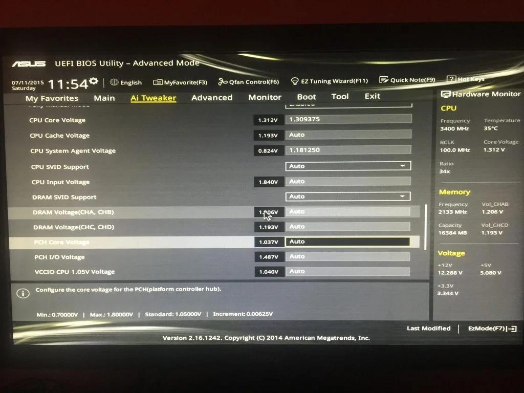

EDIT : So after a few more attempts it's still going haywire.
really bugging me now so i reset a lot of bios settings as a fresh start maybe and i was still getting the overclocking failed :(.
Have added a few photos of main bios settings that i currently have. As i said i have reset a lot of these now including ram voltages ect.
once in windows everything runs just fine as you can see from the above stability test.
SA voltage isn't linear, training can be tricky and more can be just as bad as less. Start with 1.05v and work up till 1.15v till the problem stops persisting. You'll just have to soak changes till you're able to stop reproducing the training failures
