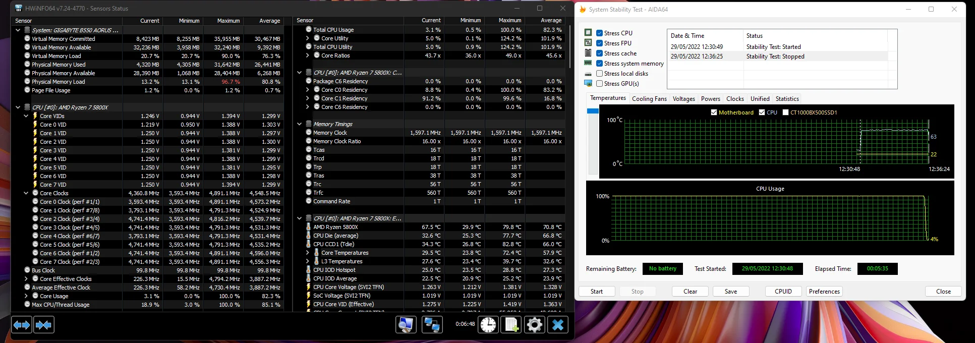

Ok update ---- So i turned as much as i caould find in the bios to do with PBO off and i also remembered that when i upgraded 5 years ago to an 8 pack upgrade system the rad they sent was essentiall diagnol to the point it doesnt fit the case 100% however i remembered that i had it as they sent out a rma replacement. (Good Ole OC)
10 minutes later old(New) radiator and Pump installed.
Load under 10 minute cinebench run
well it certainly hasnt hit the 90's which it was doing. So max temp on CCD1 88c
Tctl/Tdie 82.4c Max. Much more respectable
Stil not 100% or optimal but it will do for now until i can get the budget for new case and cooler.
Thanks all for your help. Appreciated. Will update if it starts to creep

Right Update 2 - So last night i played Star citizen for roughly 2 hours or so (before thinking my luck would run out and i would die) Temps were roughly averaging 84-85c with a max CCD 2 of 95.3 and max CPU tctl/tdie of 92.1
So i thought to myself - Case aesthetics are not everything - since the case is under my desk anyway.
This morning i have moved the Radiator to the top of the Case with the Fans above it in exhausts mode - Lid of the case wont fit but meh, i can live with that for now.
10 minute Cinebench test done and the max Tctl/Tdie temp was 69.6c. Wowsers thats come down a lot from last nights 88.4c
Still to try Star Citizen out but cant do that while working. Will do that this evening.
I think its because the rad is pipes up.
Mr Humbug currently you are correct. What a difference it seems to make.
