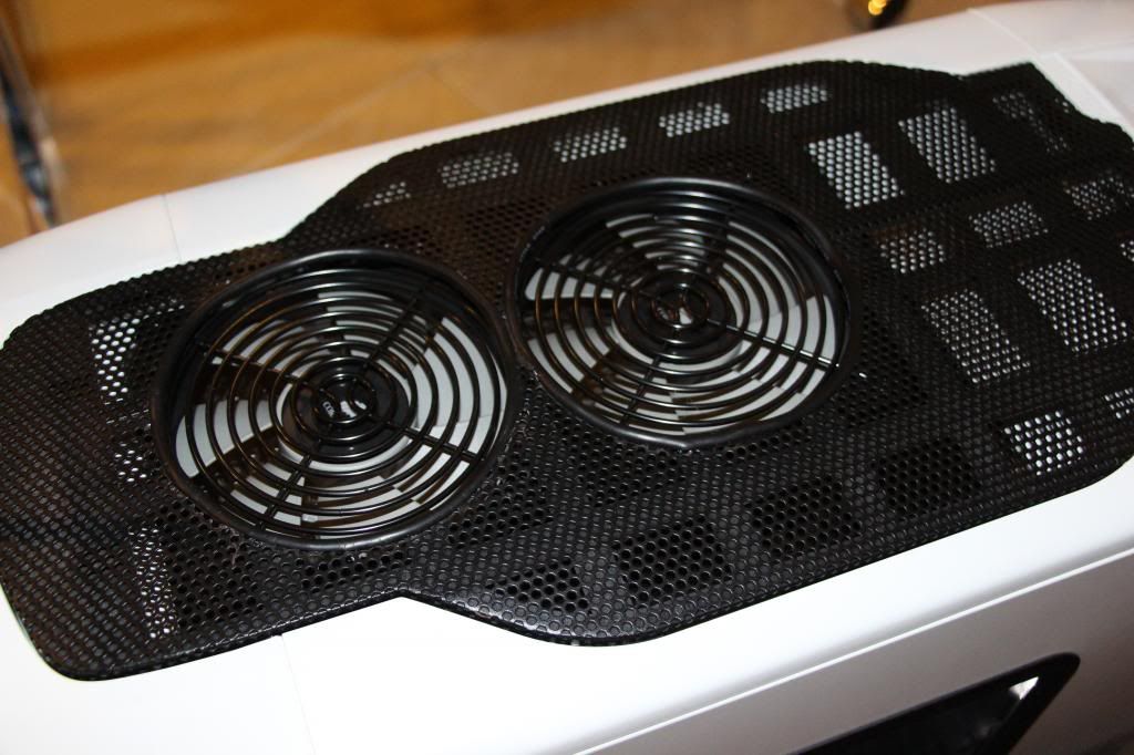

Modded my 600T for better cooling in 2 ways, firstly cut through the grill at the top, so my H100i can access fresh air (pulls air in), dramatically reduced the noise the fans (or air) were making and dropped the CPU temperature by about 8C, 5C more than exhausting.

Next up is cutting that front 200mm vent away (What is the best way to go about this? I don't own a dremel) and replace that 200mm with a bitfenix.

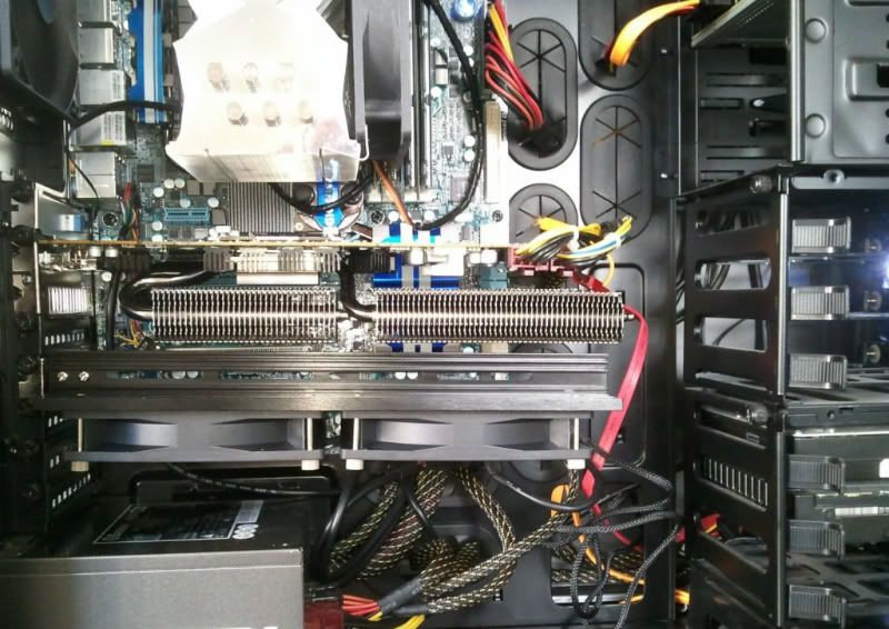

As of right now I have a 120mm fan balancing on the drive bay + psu, blows fresh air directly at the GPU and has brought my temps down by upto 5c game depending. Certainly enough to keep it under the 70c throttle point.
[New update]!
Bought the bracket and got it installed, It wouldn't work in the configuration you posted above, it was hitting my mobo with the fans so managed to find a work around, this way it cools the heat pipes on the side of the gpu too hopefully thats a good thing.
Removed hard drive trays entirely, SSD + HDD in my optical slots, I used 4mm bungee cord to string it up now its whisper quiet.
Inside shot with a little peak at my other hobby.
So anyway I have had a decrease in temps, now my max is 66c. Still playing around with fan speeds to see what i can achieve, But was hoping for lower.
