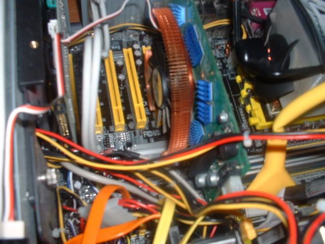

Im gonna post some pictures later to show you just how damn good these zalman coolers are, absolutely shocked I am. It justsat there at a contsant 90c, I felt the heatsink after I turnedof the pc and it was hot. Zalman you are class you saved my 6800GT.

Zalman VF700-cu (AICu)
