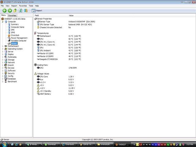

I have a XFX6800GT with the arctic cooler works perfectly fine although mines starting to die slowly (i think!) great cooler when i first brought it though & isn't all that hard to fit either :)
bare in mind my room is very very hot today! :P
